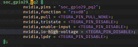

Orin Nano 8GB pinmux dtsi not work
I want to change the PQ02 IO to output mode. First, I used the pinmux spreadsheet to generate the DTSI file and replaced bootloader/generic/BCT/tegra234-mb1-bct-pinmux-p3767-hdmi-a03.dtsi, but the flashing failed.
Flash command: ROOTFS_AB=1 EXT_NUM_SECTORS=122159104 ./tools/kernel_flash/l4t_initrd_flash.sh --external-device nvme0n1p1 -c tools/kernel_flash/flash_l4t_nvme_rootfs_ab.xml -S 8GiB -p "-c bootloader/generic/cfg/flash_t234_qspi.xml" --showlogs --network usb0 jetson-orin-nano-devkit internal

the generated pinmux dtsi file:
pinmux.zip (7.6 KB)
Then I restored the DTSI file and directly modified the original DTSI file by changing the content of PQ02 as follows. The flashing was successful, but after booting into the system, I found that it was still in input mode.
modified pinmux dtsi file:
tegra234-mb1-bct-pinmux-p3767-dp-a03.zip (4.9 KB)

Now I can flash successfully and control IO output successfully. I think I didn’t modify #include so the flash failed.
Besides gpioset --mode=wait, is there any background way to permanently modify the IO status without starting the gpioset process?
