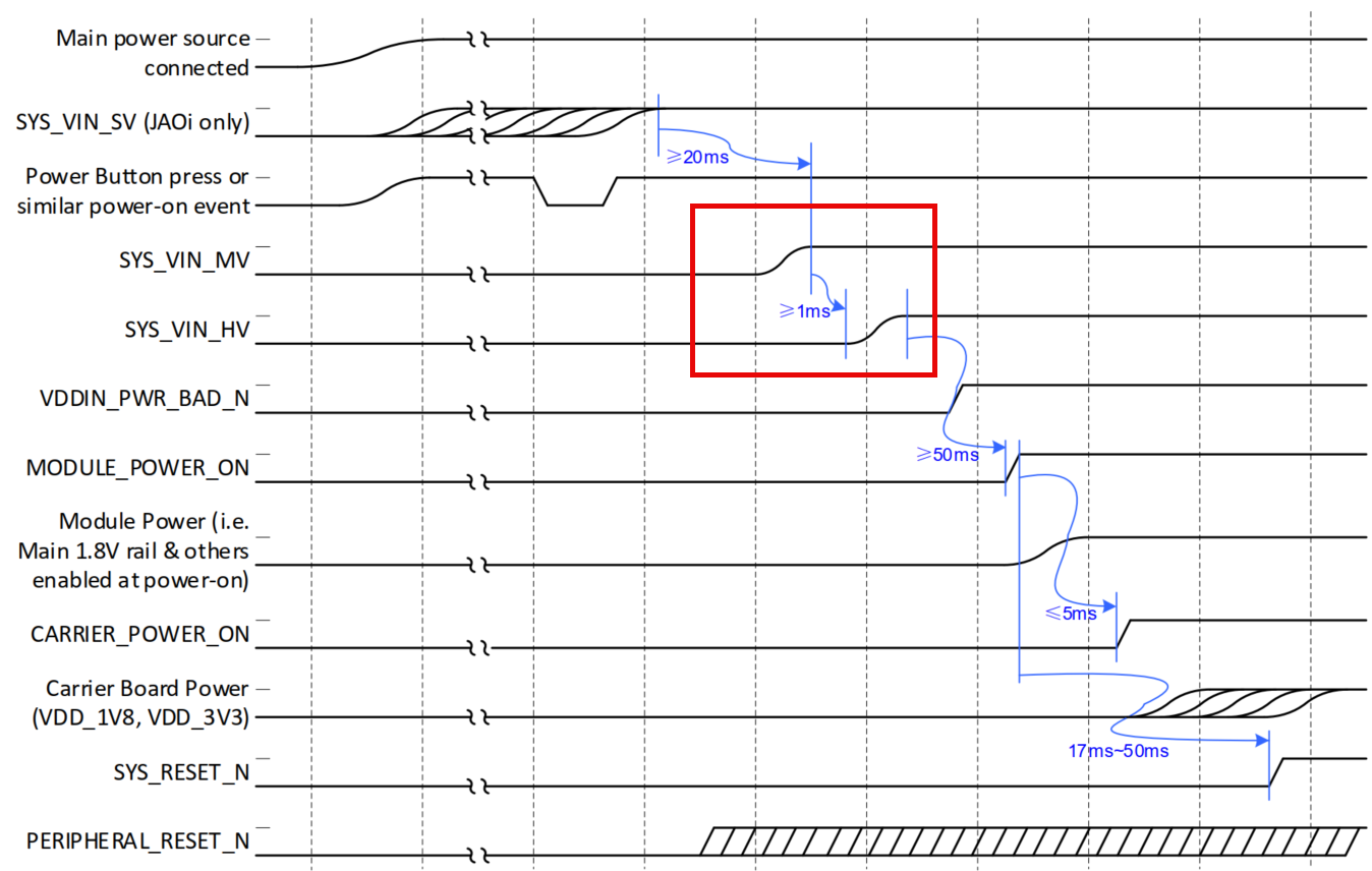

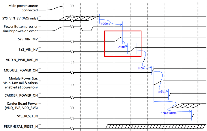

from the design, MV(5V) need to be powered up first, then HV(12V) followed. But on our board, 5V is derived from 12V, so 12V will be powered first, then 5V. Initial test shows the board is booting up OK.
My question is, 12V first or 5V first is critical? Do we must folllow the >1ms rule in design guide?

Any feedback? Actually it’s a very common issue which customer may face. Many desgins may ignor this power sequence requirement. I just want to ensure it’s saft or not.
5V(SYS_VIN_MV) is recommended to be on turned on first followed by 12V (SYS_VIN_HV).
12V first, followed by 5V within tens of ms. Is it an option?
12V first, followed by 5V after minimum of 1ms expected to work. However, please test it at your end with your intended use case.
