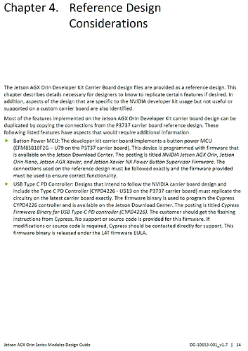

If your design is exactly the same as our reference design then the power up sequence should be as expected. Please compare the schematics thoroughly and also check the AGX Orin design guide.
Do you use Button Power MCU?
Are you using USB Type C PD Controller and is it flashed with correct firmware?
Are you powering from USB C PD path or through DC barrel jack?
Have you tried powering through DC barrel jack to measure power sequence?
