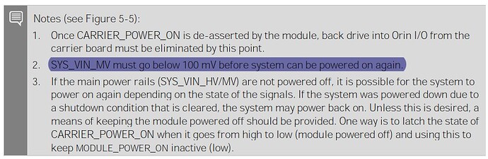

• Can you confirm if the condition SYS_VIN_MV below 100mV before next power up followed in the Jetson AGX Orin Developer Kit? And what are the effects on the SOM if this is not followed?
The below waveforms are of the Jetson AGX Orin Developer Kit:
If my reasoning is correct, the delay in the SYS_VIN_SV / 3V3_AO and SYS_VIN_MV / VDD_5V0 is introduced by the PD-Controller in the ACOK signal to the button MCU for the SYS_VIN_MV to come below 100mV. I was only able to get these waveforms from the devkit without dismantling it. From these waveforms alone I can’t confirm if the condition SYS_VIN_MV < 100mV is met on the Dev Kit as the time from PD controller supply turn on to VIN_PWR_ON high has to be considered. By a rough estimate from the waveforms and Dev Kit turn on time, I think the SYS_VIN_MV < 100mV for subsequent power on will not be met on the Dev Kit (I may be wrong). Can you please confirm the same?

Please do not compare the Dev Kit’s power sequencing with the v1.8 Design Guide.
The v1.8 Design Guide has the power sequence that should be used for all custom carrier board designs. As noted in 5.1.1:
