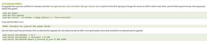

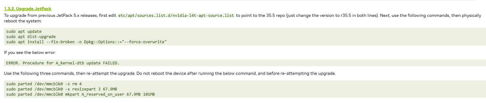

That is very unfortunate. Is there any possible way to update a 5.1.2 to 6.1 via a remote update procedure?
I tried to do a dist-upgrade on my machine using the provided information:
However I run into the problem that it tells me
TNSPEC 3767-301-0000-G.1-1-1-brla4n-orin-nx-
COMPATIBLE_SPEC 3767-000-0000--1--brla4n-orin-nx-
TEGRA_LEGACY_UPDATE false
TEGRA_BOOT_STORAGE nvme0n1
TEGRA_EMMC_ONLY false
TEGRA_CHIPID 0x23
TEGRA_OTA_BOOT_DEVICE /dev/mtdblock0
TEGRA_OTA_GPT_DEVICE /dev/mtdblock0
Info: Write TegraPlatformCompatSpec with 3767-000-0000--1--brla4n-orin-nx-.
Starting kernel post-install procedure.
Rootfs AB is not enabled.
ERROR. Procedure for A_kernel update FAILED.
Cannot install package. Exiting...
dpkg: error processing package nvidia-l4t-kernel (--configure):
However the system is booted from the nvme drive so the provided info for the emmc is not working for me. Can you guide me through on how to fix it when the system is on a nvme drive?
