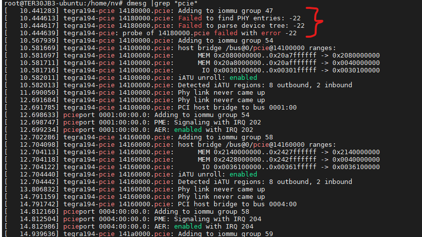

PCIE/USB设备pcie@14180000 作为PCIE打开(dts status=okey)后,phy初始化失败
log如下
root@TER30JB3-ubuntu:/home/nv# dmesg |grep “pcie”
[ 10.441283] tegra194-pcie 14180000.pcie: Adding to iommu group 47
[ 10.444613] tegra194-pcie 14180000.pcie: Failed to find PHY entries: -22
[ 10.444617] tegra194-pcie 14180000.pcie: Failed to parse device tree: -22
[ 10.444639] tegra194-pcie: probe of 14180000.pcie failed with error -22

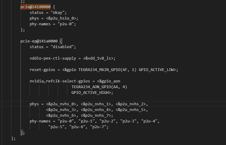

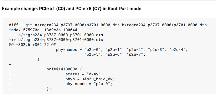

請參考文件做 只改一行status=okay是不夠的
请看下当前情况呢
其中那个D9引脚配置,我改为了Bidirectional了的
然后我从编译烧录好的系统,登上去导出了一下dts配置,以免编译配置没有生效,这是最贴切实际的配置,麻烦您看下有无错误
please read the document…
加了之后
pcie@14180000 {
status = “okay”;
phys = <&p2u_hsio_0>;
phy-names = “p2u-0”;
报这些问题,请问下具体怎么去配置呢,感觉所以依赖继承的配置,没全或者没对,同文件级别的其他pcie是配置比较全的。
如果是配置比较全的dtsi没有被依赖到,麻烦指出能够跑通功能的那个配置
报错打印信息如下
root@TER30JB3-ubuntu:/home/nv# dmesg |grep pcie
[ 9.675152] tegra194-pcie 14180000.pcie: Adding to iommu group 53
[ 9.677028] tegra194-pcie 14180000.pcie: supply vddio-pex-ctl not found, using dummy regulator
[ 9.685203] tegra194-pcie 14180000.pcie: host bridge /bus@0/pcie@14180000 ranges:
[ 9.685225] tegra194-pcie 14180000.pcie: MEM 0x2440000000..0x2727ffffff → 0x2440000000
[ 9.685232] tegra194-pcie 14180000.pcie: MEM 0x2728000000..0x272fffffff → 0x0040000000
[ 9.685238] tegra194-pcie 14180000.pcie: IO 0x0038100000..0x00381fffff → 0x0038100000
[ 9.685556] tegra194-pcie 14180000.pcie: iATU unroll: enabled
[ 9.685558] tegra194-pcie 14180000.pcie: Detected iATU regions: 8 outbound, 2 inbound
[ 10.784145] tegra194-pcie 14180000.pcie: Phy link never came up
[ 11.759953] tegra194-pcie 14180000.pcie: Phy link never came up
[ 11.760046] tegra194-pcie 14180000.pcie: PCI host bridge to bus 0000:00
[ 11.766824] pcieport 0000:00:00.0: Adding to iommu group 53
[ 11.766974] pcieport 0000:00:00.0: PME: Signaling with IRQ 206
[ 11.767566] pcieport 0000:00:00.0: AER: enabled with IRQ 206
