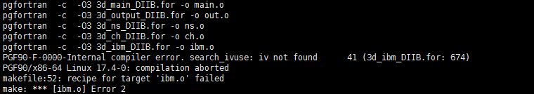

I am using pgfortran to compile my code. This code works well with ifort and gfortran compiler and when I use pgfortran with optimization flag -O0 and -O1 it can pass too. But if using pgfortran with optimization flag -O2 and -O3, it can not work. As is shown below, the difference between the two pictures is optimization flag.
Send the source code to 3D_ibm_DIIB.for trs@pgroup.com and we can determine if it
is already known and will be fixed (or is fixed) in a current or upcoming
release, or if it is a new problem that will be fixed in the future.
Be sure to also send any header files, modfiles, or modfiles sources, so we can replicate the behavior.
You have a workaround (do not compile -O2), by compiling everything
but the failing routine(s) -O2.
