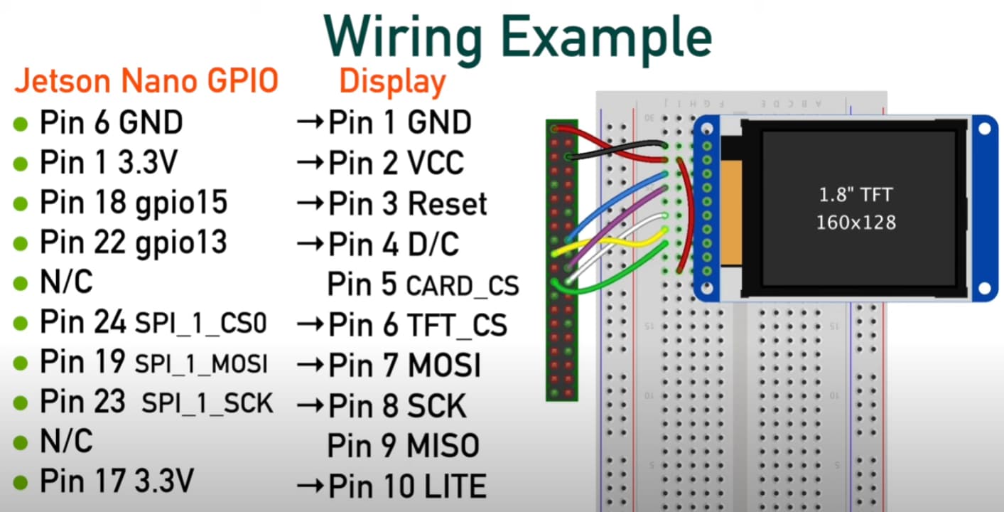

The display being used is the adafruit PiTFT Plus 480x320 3.5" TFT+Touchscreen for Raspberry Pi (PiTFT Plus 480x320 3.5 TFT+Touchscreen for Raspberry Pi : ID 2441 : Adafruit Industries, Unique & fun DIY electronics and kits). The connection is established using jumper cables as follows:
Jetson’s Pin – Display Pin
- pin12 – Backlight Control
- pin18 – RT Interrupt
- pin19 – SPI0 MOSI
- pin21 – SPI0 MISO
- pin22 – TFT Data/Command
- pin23 – SPI0 SCLK
- pin24 – TFT Chip Select
- pin26 – RT Chip Select
I am currently referencing the repository at GitHub - JetsonHacksNano/SPI-Playground.
The issue I’m encountering is that while I was able to control the backlight with Jetson.GPIO, I encountered problems when attempting to use the adafruit_rgb_display.hx8357 display module for image transmission. Following the referenced repository, I’m using the digitalio and board modules, but not only am I unable to transmit images, but I’m also unable to adjust the backlight.
I’m seeking solutions or recommendations for displays compatible with smooth SPI communication on Jetson Nano.
