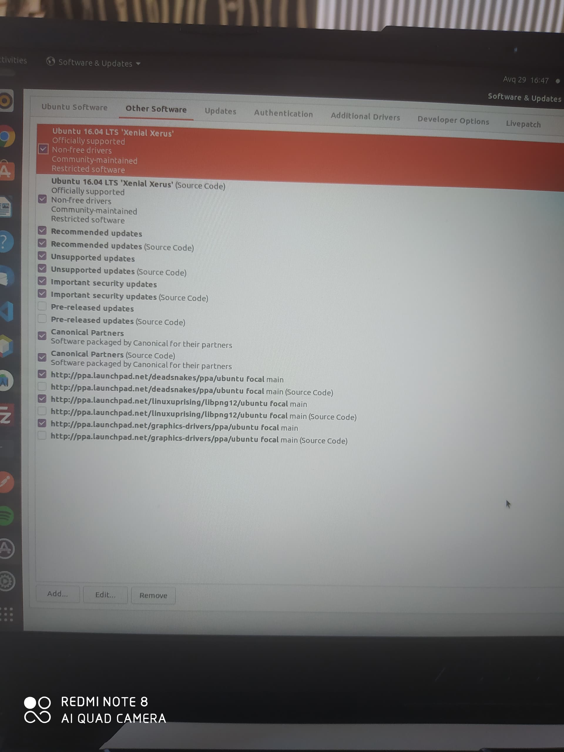

The purpose of my uninstalling python3 is that the software-updater I posted above was not opening. I want to know what was the reason.
this picture not open
That’s actually “Software&Updates”, the “Software Updater” is a different application.
The package download sources for 20.04.4 went missing (for whatever reason) so you got a stale install with inconsistent dependencies. So some application were broken.
I wanted to download excell, so I downloaded Playonlinux and some dependencies appeared, so I had to remove python
