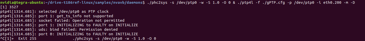

While trying to do time synchronization between SOC’s we are facing issue while executing the following command:

@VickNV, I got the following error with the suggested command
nvidia@tegra-ubuntu:~/drive-t186ref-linux/samples/nvavb/daemons$ sudo ./phc2sys -s /dev/ptp0 -w -S 1.0 -O 0 & ./ptp4l -f ./gPTP.cfg -p /dev/ptp0 -i eth0.200 -m -D
[1] 2824
ptp4l[127.295]: selected /dev/ptp0 as PTP clock
ptp4l[127.296]: Failed to open /dev/ptp0: Permission denied
failed to create a clock
Upon giving the “777” permissions to “/dev/ptp0”, I got the following errors:
[2] 2876
ptp4l[202.009]: selected /dev/ptp0 as PTP clock
ptp4l[202.011]: port 1: get_ts_info not supported
ptp4l[202.012]: socket failed: Operation not permitted
ptp4l[202.012]: port 1: INITIALIZING to FAULTY on INITIALIZE
ptp4l[202.012]: uds: bind failed: Permission denied
ptp4l[202.012]: port 0: INITIALIZING to FAULTY on INITIALIZE
Please try the same commands as mine. Thanks.
sudo ./phc2sys -s /dev/ptp0 -w -S 1.0 -O 0 & sudo ./ptp4l -f ./gPTP.cfg -p /dev/ptp0 -i eth0.200 -m -D
