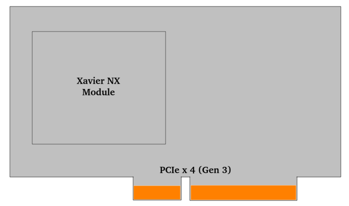

I made pcie board with Xavier NX for transfer camera image data on nx to host PC.
Xavier NX is set to EP mode, it connect to host PC (RP) through virtual ethernet using pcie port.

And he says that his test enviroments is Link width 8x, Link speed: Gen4.
But Xavier NX’s soc has only 4x pcie data line, how can he test about that?
If I use only 4x pcie data line, can I get around 5Gbps? or half? -

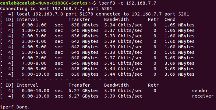

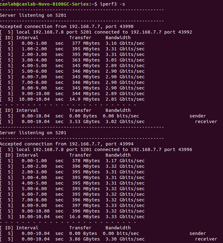

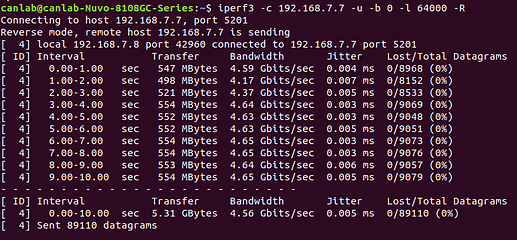

I tested bandwidth using iperf3, but result is odd.
It is slow in one direction.
Test is right? Why one direction is slow than other?
[ Case 1, use TCP ]
Xavier NX ( server ) <== Host PC ( client ) / This is fast. Bandwidth is around 5~6Gbps.
Host PC ( server ) <== Xavier NX ( client ) / This is slow. Bandwidth is around 2~3Gbps.

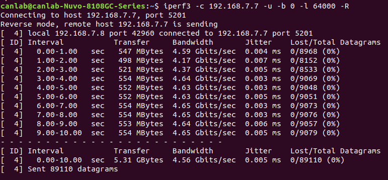

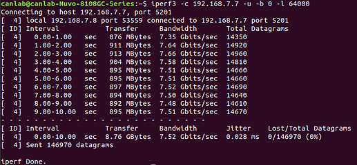

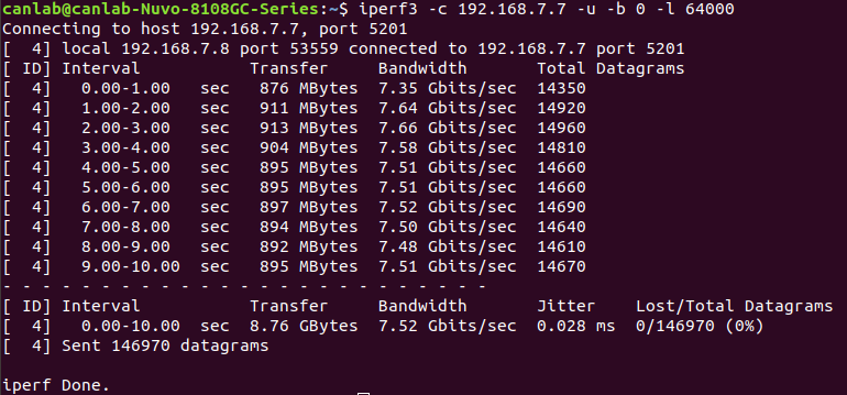

[ Case 2, use UDP ]
Xavier NX ( server ) <== Host PC ( client ) / This is fast. Bandwidth is around 7~8Gbps.
Host PC ( server ) <== Xavier NX ( client ) / This is slow. Bandwidth is around 4~5Gbps.
- According to question 3, from xavier nx to host pc bandwidth is slower than 5Gbps.
How can I transfer 5.2Gbps total camera image data with gstreamer udp stream?
iperf3 is wrong? Which app is good to test the exact bandwidth?
