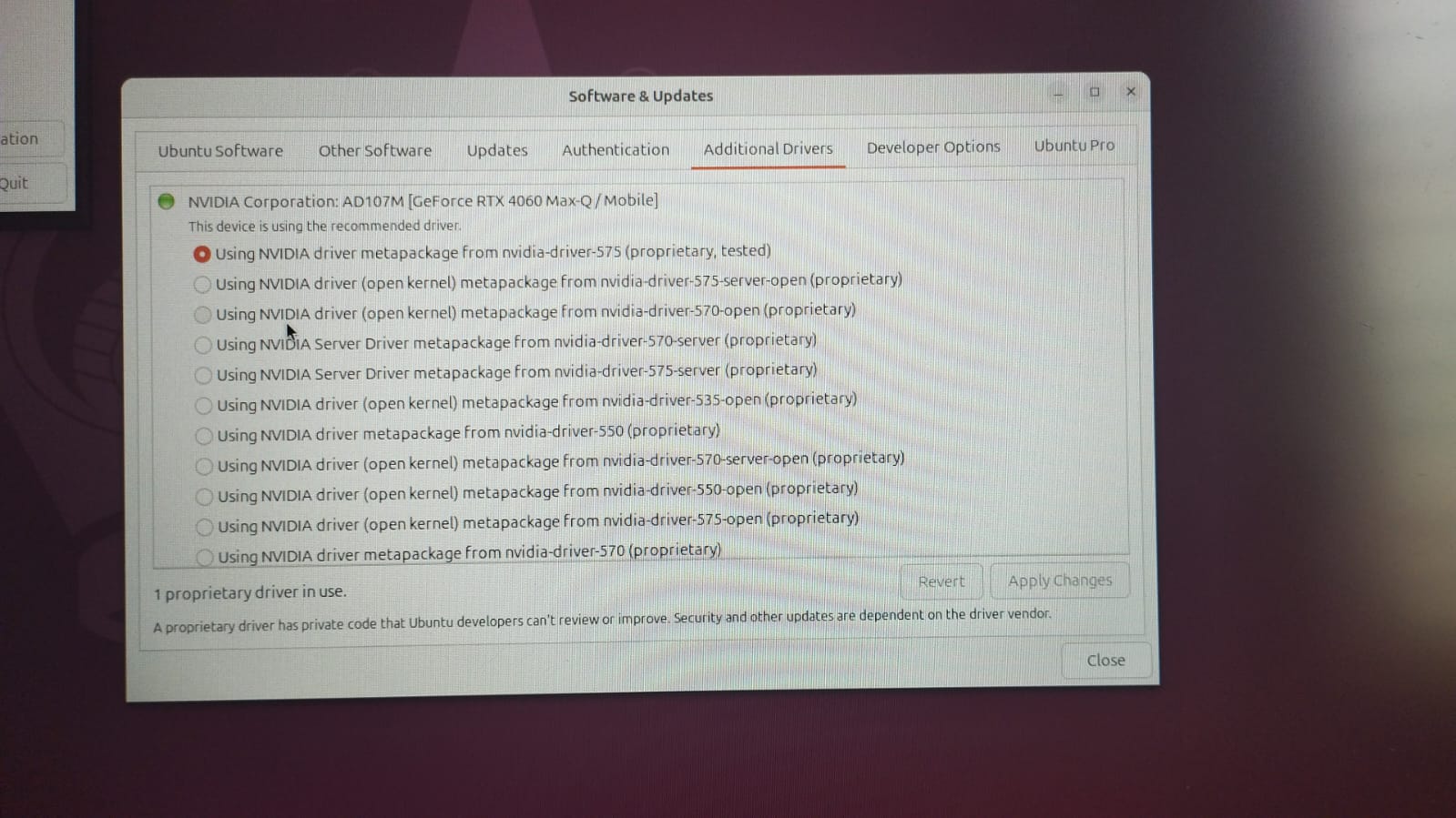

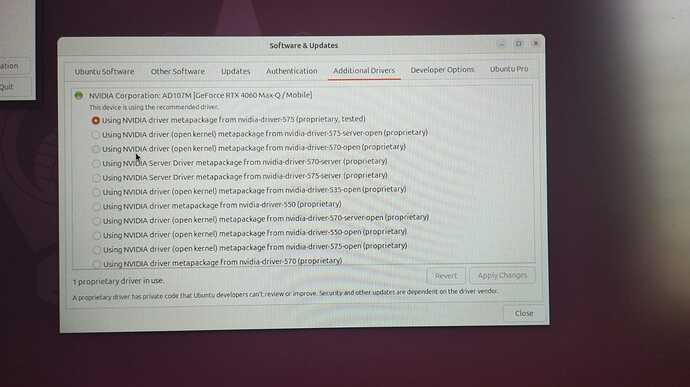

Random Freezing issues in NVIDIA GeForce RTX 4060 (Dell G16 7630 (Core i7-13650HX ) s on Ubuntu 24.04.2 LTS using Nvidia 575 proprietary drivers
Nvidia 575 proprietary drivers not compatable with Ubuntu 24.04.2LTS and NVIDIA GeForce RTX 4060 ??
Random Freezing Espeacially after entering the Passphrase(Disk Encription password) NVIDA Geforce RTX 4060 Max-Q/Mobile
Switching from windows 11 I recently have installed ubuntu 24.04.2 LTS version and started observiing Freezing issues not sure if I have to downgrade to Ubuntu 22.04 LTS as this version has been certified by UBUNTU( Dell G16 7630 (Core i7-13650HX - GeForce RTX 4060) certified with Ubuntu | Ubuntu ) for the this particular specification here- Dell G16 7630 (Core i7-13650HX - NVIDIA GeForce RTX 4060)
I dont see any certification from related to Dell G16 7630 (Core i7-13650HX - NVIDIA GeForce RTX 4060) for the 24.04 LTS version by ubuntu.
I kindly request your attention on this issue.
Try 575-open drivers they should work. The closed ones has never worked on Ubuntu 24.04 for this particular machine. The worked on 23.10 but not 24.04. I have a Dell G16 7630 4070 version.
