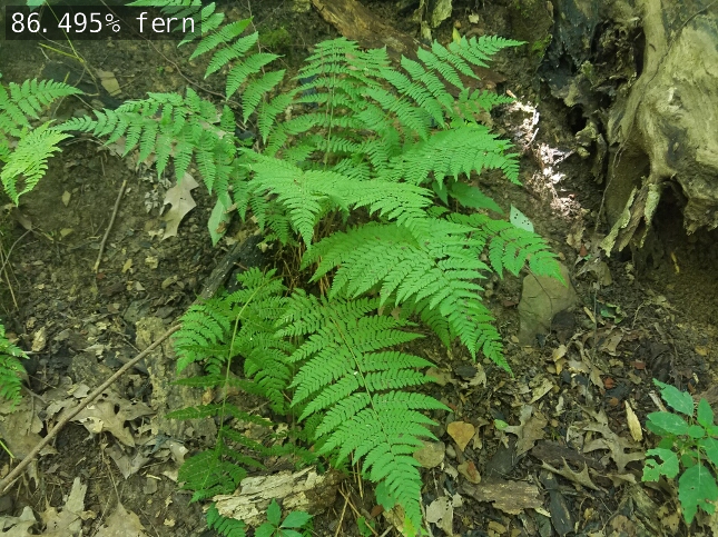

Hi Hope, are you putting a picture in front of the camera? In my experience it works better from camera when looking at an actual object. For example, some testing I did from camera around my house:
Note that the datasets for these models are intentionally kept small to keep the training time down for Nano, so while they do work ok for me, they aren’t intended to be production-quality models. With the cat/dog example, if desired you can expand the dataset to be larger.
