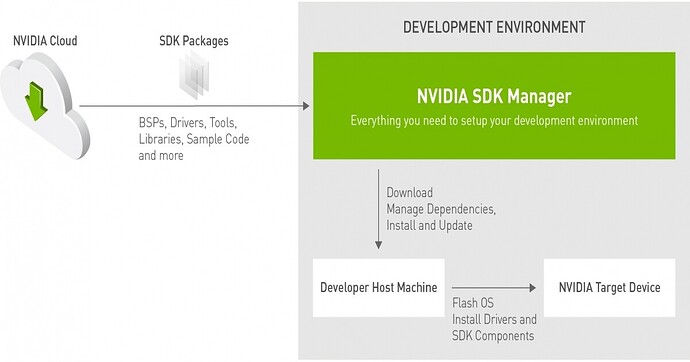

Have you installed the SDK Manager and checked if the application can detect the device in recovery mode?

In this case, we suggest to prepare a native ubuntu 20.04 later and install sdk manager to flash the device since ubuntu is more stable method.
Is switching to recovery mode required to have an Ubuntu connected with the SDK?
Recovery mode temporarily turns the Jetson into a custom USB device. This means it needs a custom USB driver, and the recovery mode Jetson is not a simple mass storage device. The flash software is that custom USB driver in combination with commands for making changes, and flash cannot occur except over the correct USB to the Linux host PC (whether in Docker, a VM, or natively). An actual flash mandates the recovery mode or the drivers won’t function.

JetPack/SDK Manager has an ability to export logs. You might want to attach the log export. Incidentally, once you use WSL or any VM one of the highest failure rates is from the environment not properly passing through USB. During a flash USB will disconnect and reconnect, and often configuration lacks what is needed to reconnect (such flashes start out working then fail during the flash).
