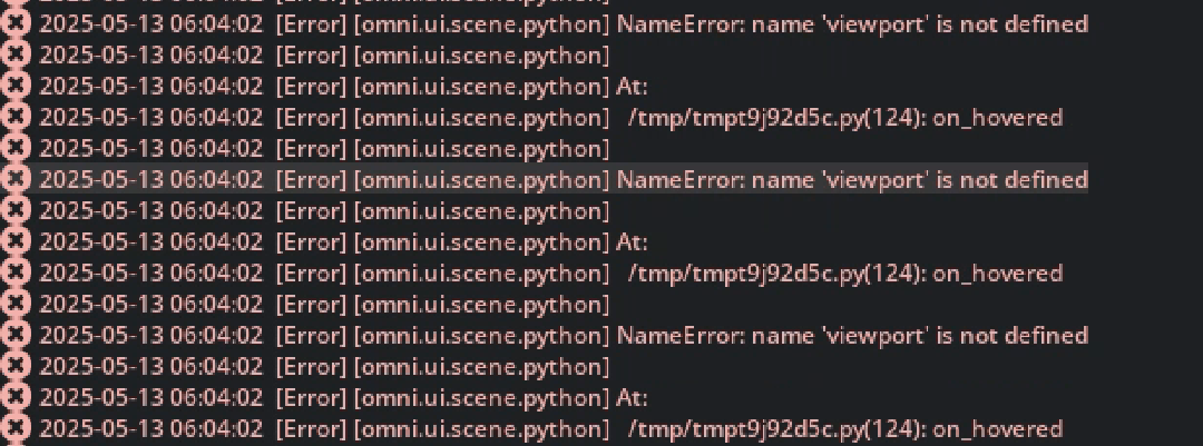

Hi Richard,
I took the script shared in the other query (Isaac Sim related) and modified to serve my purpose.
I am able to get the Outlining performed when hovered.
But, The script only works from Script editor.
When I try to run the script through the Python scripting component added to an xform, I am getting “viewport not defined” error.
Can you please check the script and help me with updating the code to work as a python scripting component.

    mouse, api = viewport.map_ndc_to_texture_pixel(sender.gesture_payload.mouse)
    if api:
        viewport.request_query(mouse, process_query)
viewport, window = get_active_viewport_and_window()
with window.get_frame("HoverHighlight") as hover_frame:
    scene_view = sc.SceneView()
    viewport.add_scene_view(scene_view)
    with scene_view.scene:
        hovered_gesture = sc.HoverGesture(on_changed_fn=on_hovered)
        screen = sc.Screen(gestures=[hovered_gesture])
Error :
