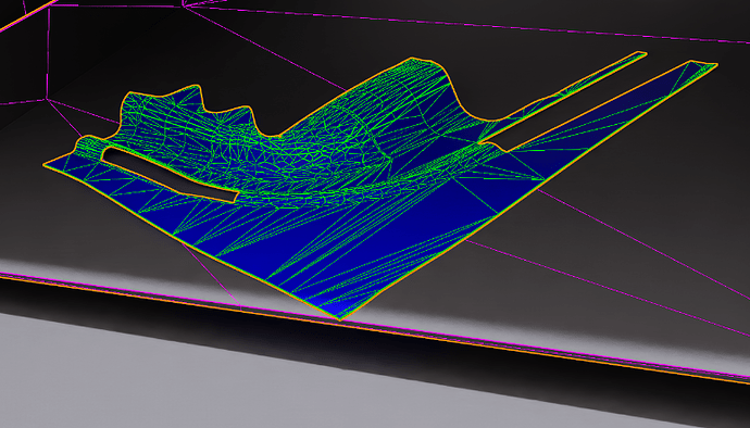

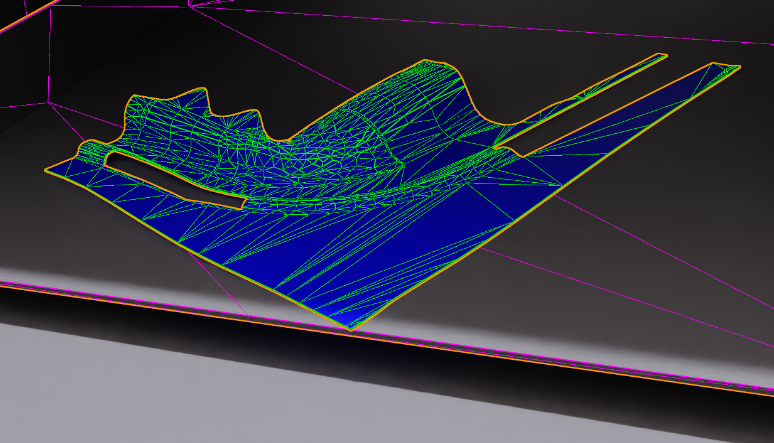

I imported a model from CATIA. I have a moving object configured as a Rigid Body with SDF Mesh for its collision property. This object is intended to slide down a fixed, inclined plane which has Triangle Mesh applied for its collision property.
When I run the simulation, the moving object collides with the edge of the inclined plane but gets stuck and does not slide down as expected. I have tried enabling both EnableCCD and Enable Speculative CCD on the rigid body, but the issue persists. How can I resolve this so the object slides down the inclined plane smoothly?

If I pull an object, it get caught in the corner

  1. I have enabled EnableCCD on the rigid body component.
  2. I have enabled Enable Speculative CCD on the rigid body component.
  3. If the rest offset value is 0.5, it can be solved, but there is a problem that the object is floating.

Hi @deokrak1004, thank you for posting your issue. Any chance you can share the asset with the SDF collision so I can debug it on my side?
