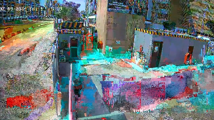

I am using deepstream-app to generate RTSP video output and playing it on VLC. I managed to view the streams on VLC at http://localhost:8556/ds-test and http://localhost:8557/ds-test on the host system. However the stream is jittery when I play it and freezes often. Here is my config file:

I am using YoloV5 inference and am trying to stream the bounding box stream via RTSP.
Could you share places where i have to troubleshoot to find why my stream is jittery?
Can you monitor the GPU and CPU loading while running the case?
You can use the command “nvidia-smi dmon” for GPU loading monitoring.

My stream looks like this with a lot of artifacts
Hi, is there anything abnormal from the nvidia-smi output?
“sm” is the GPU loading.
Is the picture you captured with the GPU loading 98%~100% or with the GPU loading is 29%~57%?
The picture is always like that regardless of the sm. Initially it starts of smooth but eventually where is a box drawn the box starts to “bleed”, leaving a trail of red everywhere.
Where and how did you display the output RTSP video? On the same machine with the deepstream-app with “localhost”?
