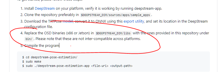

Dear NVIDIA developers,
I’m having issues with running the human pose estimation application. I was following the instructions here. I successfully ran all the steps up until Step 6, when I encountered runtime errors while trying to run the app. In other words, I compiled the app successfully, but when I tried to run it I encountered errors.
A side note: While getting the ONNX model (Step 2 of the guide I linked), I used a Docker image, which I had to modify in order to run the script to get the ONNX model.
You can find the information about my setup below:
Hardware Platform (Jetson / GPU): Tesla K80 x2 (two Tesla K80 graphic cards)
DeepStream Version: 5.0.1
TensorRT Version: 7.2.1.6
NVIDIA GPU Driver Version (valid for GPU only): 450.36.06
CUDA Version: 11.0
Issue Type( questions, new requirements, bugs): Bugs
Bug description:
This is what happens when I try to run the app I compiled:
ecmazureadmin@sendd-mj-srv02:/opt/nvidia/deepstream/deepstream-5.0/sources/apps/sample_apps/deepstream-pose-estimation$ ./deepstream-pose-estimation-app SENDD_P15_1_4_3.mp4 .
(gst-plugin-scanner:94726): GStreamer-WARNING **: 13:28:59.749: Failed to load plugin '/usr/lib/x86_64-linux-gnu/gstreamer-1.0/deepstream/libnvdsgst_inferserver.so': libtrtserver.so: cannot open shared object file: No such file or directory
(gst-plugin-scanner:94726): GStreamer-WARNING **: 13:28:59.753: Failed to load plugin '/usr/lib/x86_64-linux-gnu/gstreamer-1.0/deepstream/libnvdsgst_osd.so': libcudart.so.11.0: cannot open shared object file: No such file or directory
One element could not be created. Exiting.
I looked at this thread for potential solutions. Here are the outputs of the commands that were required suggested there:
ecmazureadmin@sendd-mj-srv02:/opt/nvidia/deepstream/deepstream-5.0/sources/apps/sample_apps/deepstream-pose-estimation$ rm -rf ~/.cache/gstreamer-1.0/
ecmazureadmin@sendd-mj-srv02:/opt/nvidia/deepstream/deepstream-5.0/sources/apps/sample_apps/deepstream-pose-estimation$ gst-inspect-1.0

I have two questions on this:
- Can the issue be stemming from how the app was compiled or is the issue just related to my environment setup?
- What is going wrong here and how do I fix it?
