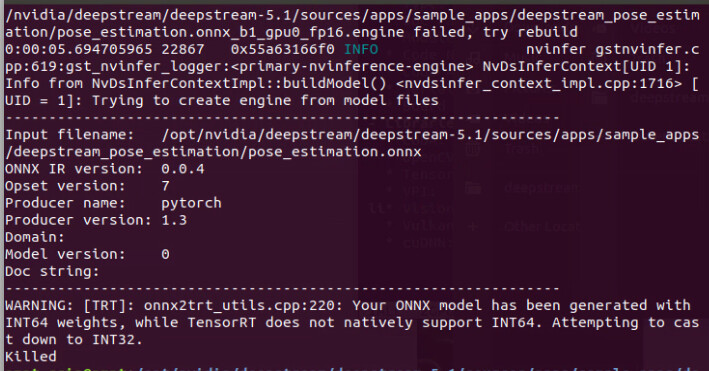

Currently, I am working on GitHub - NVIDIA-AI-IOT/deepstream_pose_estimation: This is a sample DeepStream application to demonstrate a human pose estimation pipeline.. I have followed all the steps provided in the repo. I have generated the resnet18_baseline_att_224x224_A_epoch_249.onnx from resnet18_baseline_att_224x224_A_epoch_249.pth
After that from $DEEPSTREAM_DIR/sources/apps/sample_apps/deepstream_pose_estimation I ran
sudo ./deepstream-pose-estimation-app file:///home/amnt_ssip/Downloads/out.h264 out/
After that on the output terminal message was killed. (no other error logs). So I have tried the pose_estimation.onnx model available in the deepstream_pose_estimation folder. And the same message on Terminal.
I have also tried with export GST_DEBUG=6 before running the command to print the all logs on the terminal but it’s not working.

Usually ‘killed’ is caused by the out-of-memory.
Could you monitor the device status at another console simultaneously?
$ sudo tegrastats

After this I receive message on terminal kiled.
How Can I solve this issue ?
I was going through the NVIDIA developer Blog where they have mentioned that we can use this pose estimation in jetson or NVIDIA GPU.
But while loading the model if is crashing due the out of memory how can I test it in jetson nano.
Based on the memory usage from tegrastats, Nano is running out of memory when inferencing.

Could you try to serialize the engine file with root authority?
Or another location doesn’t require root for writing?
And then please copy to engine file into the deepstream_pose_estimation sample and try it again.
I have copied the pose_Estimation.onnx file to another folder where it doesn’t require root access. and I am still getting the same error in the with --saveEngine flag.
It is not able to save the engine file in the output folder.
Could you try a command like below?
$ /usr/src/tensorrt/bin/trtexec --onnx=pose_estimation.onnx --fp16 saveEngine=/home/nvidia/pose_estimation.onnx_b1_gpu0_fp16.engine
$ sudo cp /home/nvidia/pose_estimation.onnx_b1_gpu0_fp16.engine /opt/nvidia/deepstream/deepstream-5.1/sources/apps/sample_apps/deepstream_pose_estimation/out/
