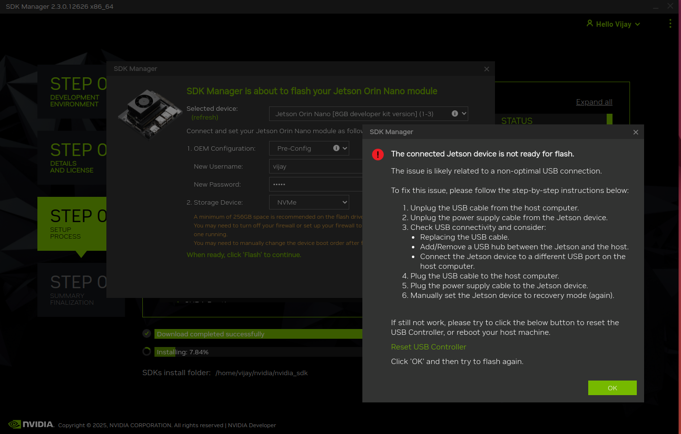

I’m attempting to flash JetPack 6.2.1 onto my Jetson Orin Nano 8GB Developer Kit using SDK Manager under WSL (Windows Subsystem for Linux) on Windows 11 (Acer Aspire 7).
Issue:
SDK Manager successfully detects my Jetson Orin Nano in recovery mode before flashing—it’s listed as an APX device in both Windows Device Manager and via lsusb from within WSL (Bus 001 Device 003: ID 0955:7523 NVIDIA Corp. APX).

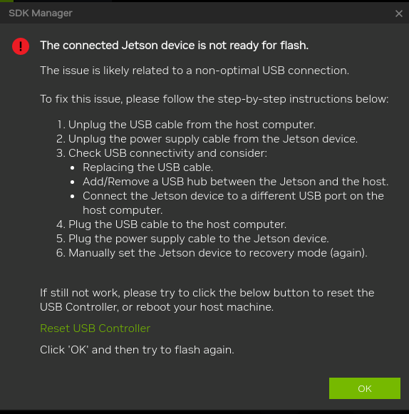

However, when I proceed to the flashing step, SDK Manager immediately reports:
“The connected Jetson device is not ready for flash. The issue is likely related to a non-optimal USB connection.”
This error appears every time I try to flash, even though the device is consistently detected right before this phase. (Screenshot attached.)
What I’ve Tried:
Verified Jetson is in recovery mode each time.
Used usbipd-win to properly forward the APX device to WSL.
Swapped multiple USB data cables (USB-C to USB-C, USB-A to USB-C), tried various USB ports (including direct USB 3.0 and USB 2.0), and avoided hubs/adapters.
Unplugged/replugged Jetson power, entered recovery repeatedly.
Reset USB controller, rebooted laptop.
Retried with different WSL distributions and fresh installs.
Each time,
lsusbin WSL shows APX/NVIDIA device present, but SDK Manager always fails at “ready for flash”.
Additional Info:
Target: NVMe SSD.
The error persists regardless of cable, port, WSL setup, or storage device.
Issue begins after successful device detection, at the actual flashing step.
Question:
Has anyone overcome this USB/WSL flashing issue in SDK Manager?
Are there alternative solutions or drivers for reliable flashing under WSL/Windows?
Is native Ubuntu (bare metal or live USB) the only practical way?
Any advice or guidance is appreciated!
