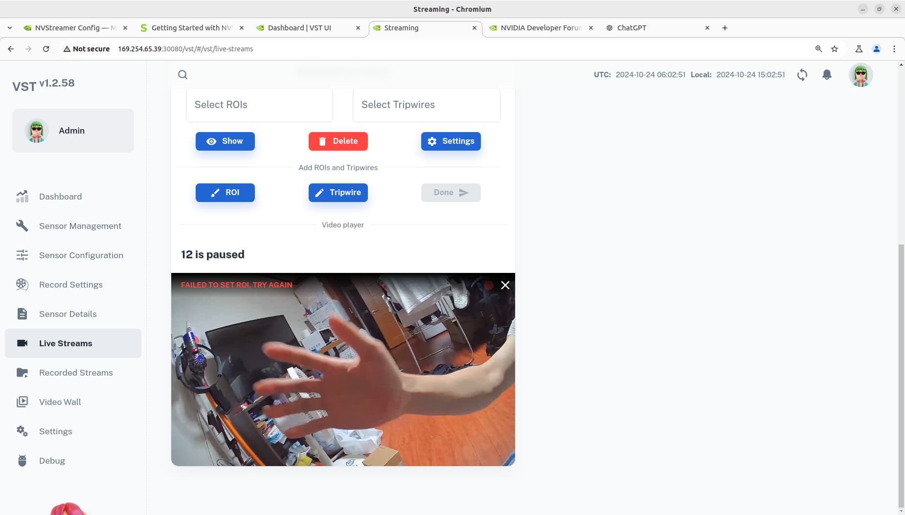

we encountered an error(error masage : Failed to set ROI, try again) while uploading an RTSP file to NVStream and setting ROI in live stream. we are using a QND-6012R camera and a Jetson AGX Orin. Our video is HEVC.mp4 at 30 frames per scecond in 1920X1080. Since we are not experts in this area, please provide detailed troubleshooting steps. Thank you. I’m really nvidia person. !!!
hello okchoi123,
may I know what’s the resolution of your ROI (Region Of Interest)?
BTW, please see-also Topic 308574 for some limitations of AeRegion()
Are you deplay AI NVR workflow based on the guide here: Quick Start Guide — Metropolis on Jetson documentation 0.1.0 documentation?
Yes I did it one more time after got your reply, but still not working. But I have an question. Do I have to follow all the guides in order? Or do I have to go through the hyperlinks that are hanging in between, do everything, and then follow the next steps?
Yes, you need follow those steps to deploy AI NVR.
