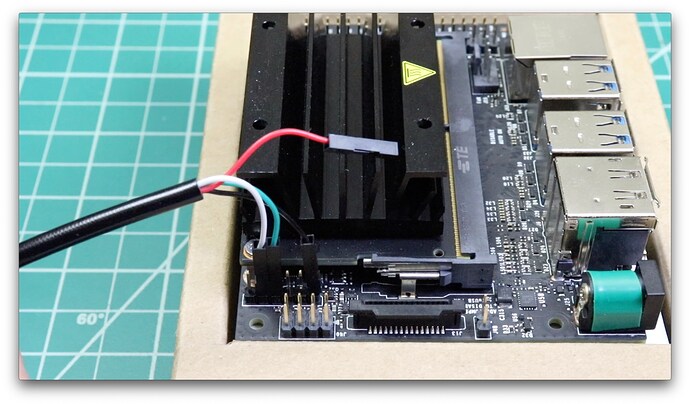

Dear all,
I have try all of combination, using balena etcher 1.5.53 at Windows 10 and ubuntu 18.04 using a 32 GB Sdcard and a 64 GB Ultra 10 Sdcard with jetson-nano-sd-r32.2-2019-07-16.zip and dlinano_v1-0-0_image_20GB.zip (using *.zip and *.img). I also try to SDK Manager 0.9.13.4763 to 32 GB and 64 GB.
External Media
My Jetson Nano’s serial number is 042(1219)046135
External Media
I try format a 32 GB sdcard with ext4 then here is my last attempt to flashing the Nano, Saturday Agu 10 16:40:37 GMT+7 2019. It still stuck at Writing partition APP with system.img. Argghh!

I am connecting The Jetson Nano J44 header
Jetson Nano J44 Pin 2 (TXD) → Cable RXD (White Wire)
Jetson Nano J44 Pin 3 (RXD) → Cable TXD (Green Wire)
Jetson Nano J44 Pin 6 (GND) → Cable GND (Black Wire)

I try to issue
$ sudo minicom
Welcome to minicom 2.7.1
OPTIONS: I18n
Compiled on Aug 13 2017, 15:25:34.
Port /dev/ttyUSB0, 21:24:15
Press CTRL-A Z for help on special keys
Power off/on/off the Jetson Nano, it display nothing at all.
Is there any way to make this sdcard bootable at Jetson Nano (dev kit)?
Thank you very much in advance.
