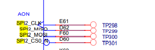

Does NX have spi2 pin out?
My board spi2 has test points

For your case is SPI2, never mind just connect the MOSI to another MOSI and MISO to MISO for two device(master/slave) loopback test.

Looks like the dts didn’t configure the SPI pin like jetson-io do.

spit@user-desktop:/home/user# cat /sys/kernel/debug/tegra_pinctrl_reg | grep -i s
Bank: 1 Reg: 0x0c302028 Val: 0x00000400 → spi2_mosi_pcc2
Bank: 1 Reg: 0x0c302038 Val: 0x00000400 → spi2_cs0_pcc3
Bank: 1 Reg: 0x0c302048 Val: 0x00000400 → spi2_sck_pcc0
Bank: 1 Reg: 0x0c302050 Val: 0x00000450 → spi2_miso_pcc1

It’s could be device tree over write it.
Should modify tegra19x-mb1-pinmux-p3668-a01.cfg for Xavier NX platform.
