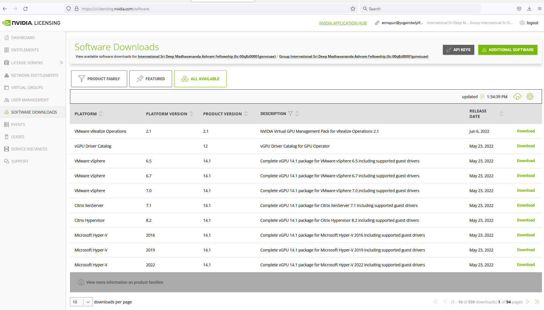

3.) If I go here:
and try to register for a trial version of vGPU software, it is not possible to specify Hyper-V. And the Hypervisor field is marked as “required”. How to get the driver?
Our machine is certified for vGPU (ProLiant DL380 Gen10) although we will only be using one card within one VM with it:
https://www.nvidia.com/en-us/data-center/resources/vgpu-certified-servers/
After pretending to use the VMware Sphere, I got to see this:
And the questions would be:
a.) Is the Nvidia Microsoft Hyper-V 2016 Software to be installed in to the Host or in to the Guest?
b.) Is there any support from Nvidia Installer to Configure Microsoft DDA?
