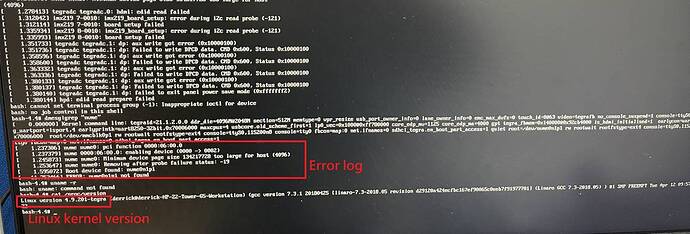

The device can't detect PCIE SSD
The device can’t detect the pcie SSD, it always stop at bash4.4 as the pictures
it’s random issue and please help
thanks
https://git.kernel.org/pub/scm/linux/kernel/git/torvalds/linux.git/commit/drivers/nvme/host/pci.c?id=3a8ecc935efabdad106b5e06d07b150c394b4465
I tried to change kernel pci.c driver file and compile image then flashed in Nano , but it still get the same error
