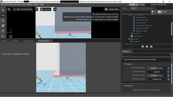

2 years ago somebody detected problem when an annotator output is always delayed for 2 frames.
I ran into the same problem when tried to get rendered frames in a graph powered by the On Physics Step node. Actually, there were 2 problems:

If you try to get a data from an annotator inside a graph powered by On Physics Step node, you will always get it lagged by at least a frame because at this moment a PostRender graph with GPU Interop: Render Product Entry node (which gives rendered frames on GPU for an annotator) for your render product has not been evaluated for the current simulation step yet.
  1. The simulation time by default is ahead of the playback time by 1-2 frame because the isaacsim.core.simulation_manager.SimulationManger.initialize_physics method which is called when its warmup is needed (usually during isaacsim.core.api.world.World.reset()call or a simulation reset) does two simulation steps (the second step in _create_simulation_view, see comment 2):

As there is no any direct access and documentation to the RTX Render, I am tied to the SyntheticData’s PostProcess graph. I haven’t tried to evaluate my logic right after the PostRender graph for my Render Product. When I was digging in built-in Profiler traces, I noticed that the render is always completed before the post-render stage where PostRender graphs are evaluated andPostProcess graphs are evaluated at the beginning of the kit’s update. I am not sure why the execution order for PostProcess graphs is -100 (the very begining of the kit update stage) then, there might be the constant 1 frame lag between Render Products render results and the simulation, but… (see the figure 2 and 3).
I have no free unpaid time and can not do a complex research now, but I can share some results I got earlier. Excuse me for .jpeg screenshots:
Here you can see the 2 frame lag between the render results (58 frame) and the simulaton (60 frame). physics_dt = rendering_dt = 60, startTimeCode = 0 for the stage and the Simulation Manager is doing two physics steps during an initialization. My graph is driven by the On Physics Step node. When the simulation time equals to 1 second or more, it gets a frame from an omni.syntheticdata.SdRenderVarPtr LdrColor node annotator related to a Render Product and stops the playback. The application is running in the GUI + Extension workflow so there was at least 1 GUI simulation reset.
Here the left window shows the render result after 60 World.step(), the right one shows the render result during 60th World.step() right after the 61th physics step. The application is run by a Python script similar to the one I uploaded in the first post. In the script I’m doing a non-pausing Replicator’s step, World.reset() and then 60 World.step(). There is no a GUI simulation reset, but the right render result has a 1 frame lag. And I am honestly do not know why the left one is frame-perfect if the PostProcess graph still must contain a result of the previous frame.
The previous setup but with only one step during the Simulation Manager initialization. The results the same. Do not have any clues about it.
