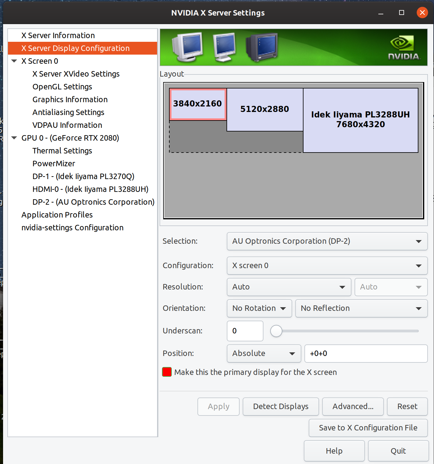

Ubuntu Kernel v5.6, v5.7 for HP-OMEN 17t bc000 GForce RTX2080 unstable driver NVIDIA-Linux-x86_64-440.82.run
I have a laptop HP-OMEN 17t bc000 GForce RTX2080 with monitors Idek Iiyama PL3270Q and Idek Iiyama PL3288UH
I observe a very unstable driver NVIDIA-Linux-x86_64-440.82.run for Ubuntu Kernel v5.6.4
Constantly reset current settings with access to the login window
At the same time, the screen blink
Some windows immediately lose controls
setting|660x500
For version 5.7.0-rc1, along with the patch for the driver, it works even more unstable

Made monitor settings
However, some windows still lose the display of controls.
After 5 minutes, all monitors went out and restored in the wrong sequence
When trying to restore order, the system logged out by closing all applications on such a screen
At the same time, the sudo nvidia-bug-report.sh --safe-mode log is still empty nvidia-bug-report.log (547 Bytes)
The same problems on kernel 5.6.4 without a patch

Just a note: setting modes/orientation/whatever through the nvidia-settings application is not wise on Gnome. Gnome has its own monitor manager that gets easily confused if monitor settings gets altered by any other application like nvidia-settings or xrandr.
I sent you a screenshot of the problem with the monitor selection window
The control buttons are not visible there.
Also, any reboot of the system does not save the applied monitor settings
This window works fine only if I turn off both monitors

I don’t know where this comes from, but something set some mad nvidia metamodes. Did you use nvidia-setting again or do you have some service or plugin installed that does that?
How to remove this “some mad nvidia metamodes” ?
No I not used nvidia-settings again.
Maybe some settings in the config files? Please attach /etc/X11/xorg.conf
xorg.conf.log (4.6 KB)
I set the scale on the laptop screen again to 200% and again the window elements ceased to be displayed and the arrangement of the screens ceased to be remembered.
And one of the PL3288UH monitors does not start after login. You need to disconnect the hdmi and reconnect it
Your xorg.conf doesn’t make sense in many ways. Please delete it and reboot. You shouldn’t need any xorg.conf.
