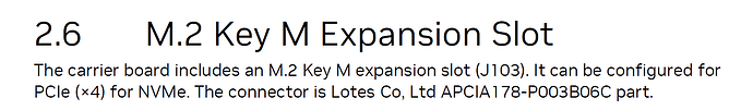

In the Jetson Thor Development Kit, there is an M2.M Key Connector for UFS. Is there any existing UFC card that can be used for testing? If not, I am about to design my own UFS storage with the M. 2 M key form factor. Does the UFS interface used in Jetson Thor support 4.0? Or 3.1 only?
Refer to the Jetson Thor Design Guide for supported features. Please use NVMe with M2.M Key. UFS is not supported on Jetson Thor T5000.
How about this J1 M.2 KEY M for UFS, which is existing on the Development Kit. Does it support UFS?
I have checked Jetpack 7 for Jetson Thor. It does have the configuration option #7 for UFS.
There is no validation for that. UFS is not supported on Jetson Thor.
Does that mean UPHY0 Lane6 and Lane7 can only be configured to be #6 as 2 Lane PCIe? am I right?
Does NVIDIA have a plan to enable UFS for Jetson Thor in the future Jetpack release?
Correct.
No, only IGX will support UFS. AGX won’t.
