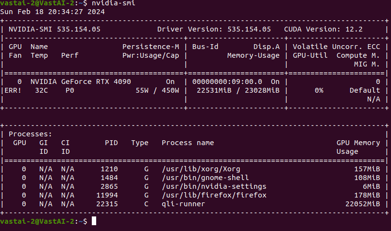

Here’s what nvidia-smi shows
The fan is already in error state, likely due to overheated memory. In that state, it’s locked at 100%.
It is in that error state even after a reboot or when the GPU is cold. Are you saying that the memory overheated at some point and this error is permanent?
If it’s in ERR! state right after boot, it’s not overheating at all but the fan control is malfunctioning in general. Please try upgrading driver to latest.
I’ve tried 525 and 535 drivers now, is there something even more recent?
545/550beta
550 beta did the trick! Thanks for the tip!!!
