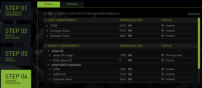

Environment :
SDK : Jetson SDK 4.6
Host-PC : Ubuntu 18.04.03
ISSUE:
We are unable to Install “Nvidia Container Runtime with Docker Integration” to the target machine.
Please find below the screenshot
Let us know how to resolve/install nvidia container runtime docker on agx
SDKM_logs_JetPack_4.6_(rev.2)_Linux_for_Jetson_AGX_Xavier_modules_2021-10-28_18-33-34.zip (174.5 KB)
Could you please give a resolution on this or any other updates/feedback

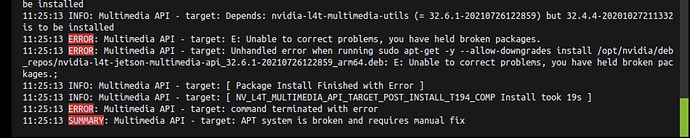

Hi all,
I also encountered the same problem. I insert here the screenshots of the errors reported
Exactly the same here - EXTREMELY frustrating!
The problem seems to be that newer versions of dependencies are to be installed than are allowed - is this really a problem??? In fact, I would very much like to run a docker container and also use the multimedia components …
Oh, and one more thing: I would like to add that having to FAKE a Ubuntu 18.04 for flashing is also just incredibly - I don’t even know what to call it - let’s try “peculiar”.
Have you fixed this issue already?
SDKM_INSTALL_ERROR E: Failed to fetch http://ports.ubuntu.com/ubuntu-ports/pool/main/g/gettext/autopoint_0.19.8.1-6ubuntu0.3_all.deb Connection failed [IP: 172.28.80.65 8080]
Based on the log above, the error is caused when downloading a package from the Ubuntu website.
Could you try that if you can download the file manually?
