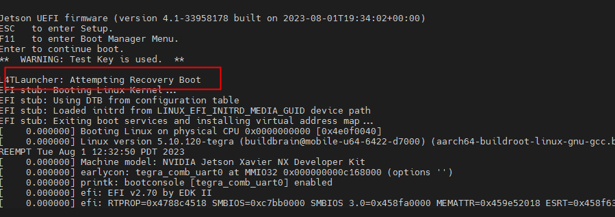

Under what circumstances does UEFI start recovery mode
Today I conducted an experiment where the factory product requires the removal of the Linux version number. During the reboot test, I restarted several times and UEFI entered recovery mode. Is this related to the Linux version I changed
連續數次開不進rootfs並且讓某個systemd service 正確執行的話就會進Recovery image.
另外, 這模式不是recovery mode.

做了实验,连续reboot重启,第四次就会进入这个异常模式,哪里是不是有限制,不让重复重启?
如果你有看懂我這句的意思的話, 現在這個狀況聽起來是這個systemd service沒有正確執行
或是還沒執行就被你重開機了
請你確認 nv-l4t-bootloader-config.service的status都有執行完之後再進行reboot.

原因知道了,那么对于这种处于ramdisk的状态下,如何快速修复呢
只有上面提到的方法.
如何关闭这个功能
  1. If you want to disable the feature of “rootfs check to enter into recovery boot”, you can comment out the calling of function ValidateRootfsStatus()
    (i.e. from line 1697 to 1700 in the following link)
    edk2-nvidia/Silicon/NVIDIA/Application/L4TLauncher/L4TLauncher.c at r35.4.1 · NVIDIA/edk2-nvidia · GitHub
  2. There would be side effect after disabling this. Your image based OTA will not work.
