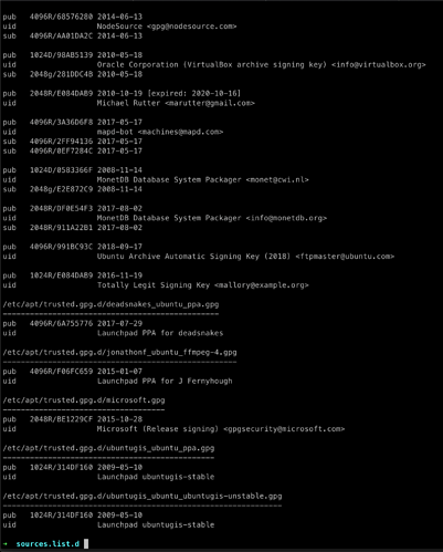

Hi!
I resolved the monetdb.org by replacing it with xenial.
As for the cloud.r-project.org, I’m not sure how to replace the GPG key. I’ve tried other methods on stackoverflow but it doesn’t seem to get replaced. I suspect it’s because it looks like I have a duplicate key. Here’s my apt-key, I’m not sure what to do if there’s a clash of key IDs
Based on my quick skim thru the R website [1][2], I’d suggest the following to delete the duplicate key:
gpg -delete-key "Totally Legit Signing Key"
Please also see the “Secure APT” section [3]

Yup, I’ve done that. Seems like it works now! Though I’m looking at the DGX OS upgrade, it seems to be removing nvidia-docker, has that been deprecated? If it has been, what’s the replacement or where can I find the documentation?
Yes, nvidia-docker, which was a wrapper to the docker CLI, has been deprecated starting in the DGX OS 4 releases [1]
It was replaced by the nvidia-container-runtime [2][3]
