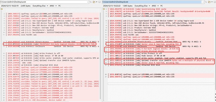

USB device not recognized,Please help me see

root@tegra:/home/robot# lsusb
Bus 002 Device 004: ID 8086:0ad4 Intel Corp.
Bus 002 Device 005: ID 0781:55ae SanDisk Corp.
Bus 002 Device 002: ID 0bda:0420 Realtek Semiconductor Corp. 4-Port USB 3.0 Hub
Bus 002 Device 001: ID 1d6b:0003 Linux Foundation 3.0 root hub
Bus 001 Device 006: ID 2c7c:0125 Quectel Wireless Solutions Co., Ltd. EC25 LTE modem
Bus 001 Device 005: ID 046d:c21f Logitech, Inc. F710 Wireless Gamepad [XInput Mode]
Bus 001 Device 003: ID 303a:4001
Bus 001 Device 002: ID 0bda:5420 Realtek Semiconductor Corp. 4-Port USB 2.0 Hub
root@tegra:/home/robot# lsblk  -------------->>>>>>>>>>>No USB device recognized.

root@tegra:/home/robot# dmesg
[18595.896676] usb 1-2.3: new high-speed USB device number 4 using tegra-xusb
[18596.036519] usb 1-2.3: New USB device found, idVendor=0781, idProduct=55ae, bcdDevice=80.55
[18596.036523] usb 1-2.3: New USB device strings: Mfr=2, Product=3, SerialNumber=1
[18596.036525] usb 1-2.3: Product: Extreme 55AE
[18596.036526] usb 1-2.3: Manufacturer: SanDisk
[18596.036528] usb 1-2.3: SerialNumber: 32333337394D343032333931
[18596.040384] scsi host0: uas
[18597.272865] scsi 0:0:0:0: Direct-Access     SanDisk  Extreme 55AE     8055 PQ: 0 ANSI: 6
[18597.282817] scsi 0:0:0:1: Enclosure         SanDisk  SES Device       8055 PQ: 0 ANSI: 6
[18597.291955] sd 0:0:0:0: [sda] 7813971617 512-byte logical blocks: (4.00 TB/3.64 TiB)
[18597.300108] sd 0:0:0:0: [sda] Write Protect is off
[18597.305057] sd 0:0:0:0: [sda] Mode Sense: 37 00 10 00
[18597.305379] sd 0:0:0:0: [sda] Write cache: enabled, read cache: enabled, supports DPO and FUA
[18597.314384] sd 0:0:0:0: [sda] Optimal transfer size 1048576 bytes
[18597.368126]  sda: sda1
[18597.370090] sd 0:0:0:0: [sda] Attached SCSI disk

Hi WayneWWW:
custom board
Is the device in question the SanDisk? If so, then it is working. Plug-in shows ID of “0781:55ae”. You could list this by itself with:
lsusb -d '0781:55ae'
Your earlier lsusb shows:
This is the job of USB. Then USB announces the device (it is hot plug) and a driver sees it and takes ownership. That ownership is only indirectly related to USB. In this case dmesg could not have shown this if the driver was not loaded for the SD card controller plus SD card:
There is yet more that might go on related to drivers. For example, there is a driver scheme for the partitioning. Once partitioning is covered, then there is another driver for the filesystem type. It is quite possible that if there is no partition, then something listing partitions might not show anything.
Something to illustrate and consider: The file “/dev/sda” shows up. That is not a real file, it is a driver pretending to be a file and lives only in RAM. Without the disk as a whole (it might be an SD card, but it is still a disk so far as the software cares at that level), there would be no “/dev/sda”. There is one partition, it is “/dev/sda1”. This also shows up in your lsblk:
sda            8:0    0   3.7T  0 disk
└─sda1         8:1    0   3.7T  0 part
You might get more use if you also have this list the filesystem type:
lsblk -f /dev/sda
(you could just “lsblk -f”, and see everything)
If partition sda1 is formatted, then maybe it can be mounted. If it is a VFAT filesystem, or an ext4 filesystem, or anything else, then that filesystem driver must first be present. If not formatted, then no mount can do anything, although it could be treated as binary data. What do you see from “lsblk -f /dev/sda”?

左边是不正常的,右边是正常的。
出问题的时候,左边lsblk没有sda信息,右边正常的有sda信息。

b.txt (1.8 KB)
a.txt (2.3 KB)
The left side is normal and the right side is abnormal.

正常的识别的情况,两种型号对比:
你貼這種diff沒有什麼幫助 如果要給log就把兩種不同SSD的完整log都貼上
另外, 如果你的測試是在NV devkit上面, 接下來得請你抓USB bus trace, 如果你沒辦法抓. 就請你先把能給的log給完整.
