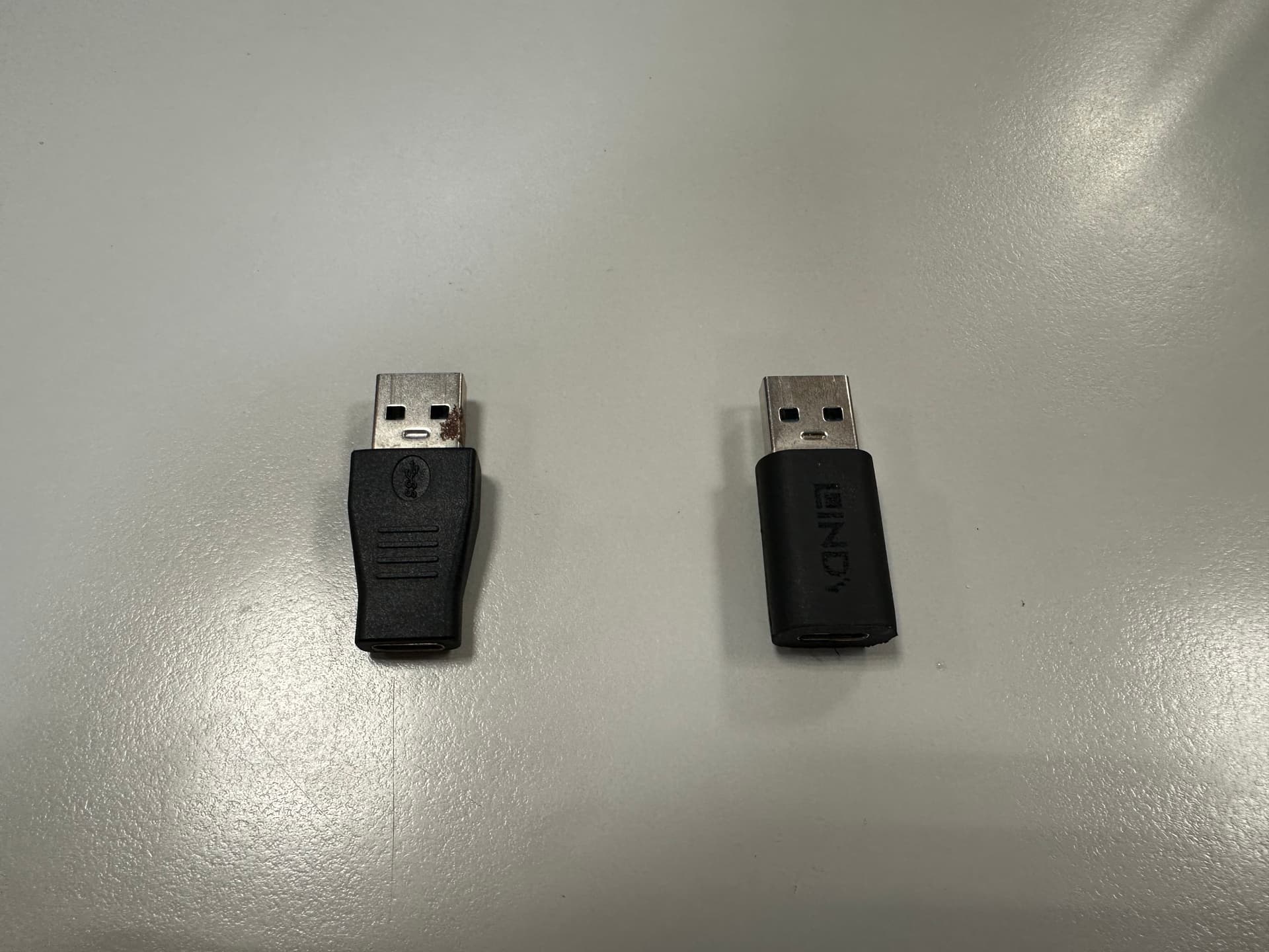

  1. hotplug your type C cable on Jetson and see if dmesg prints out something new?
  2. could you use a type C to type A adapter on that port and connect to some simple usb devices (e.g. keyboard/mouse) and see if it could be detected?
Here is the result of the testing:
  1. No. When I connect the board to the host computer, both instances of sudo dmesg -w remain unchanged.
  2. Yes, I connected a mouse using a Type-C to Type-A adapter, and it functioned properly.

I switched to a simple USB-A to USB-C cable, and it worked properly. I have no idea why this happened.
This A-to-C cable came from our depth camera, and it is working fine now.
The original cable I used was a PHILIPS DLC4585C USB-C to USB-C cable. It works properly for everything except communication between the host computer and JetPack 6.2.
This is really bizarre.
So you mean if you switch the cable, then usb device mode is fine?
Yes, and I also tested this PHILIPS cable by connecting the host computer to my iPad, but it failed.
Then, I switched to the USB-A to USB-C cable, and it worked properly.
Finally, I switched the USB-A to USB-C adapter from the left one to the right one, and the PHILIPS USB-C to USB-C cable worked properly for both JetPack 6.2 and my iPad.
The only difference between these two USB-A to USB-C adapters is that the left one is USB 3.2 Gen 1, while the right one is USB 3.2 Gen 2.
I still find it bizarre that the original setup only worked properly in specific situations. Anyway, changing the USB-A to USB-C adapter solved all the problems.
I apologize for wasting your time on debugging this.
