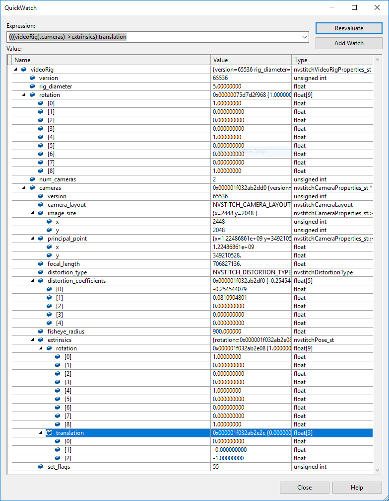

Is the output xml file sensible? My output xml file contains a focal length of about 3000px whereas according to my calculations it should be 300-500px. When I use the output xml file, my stitched output is an all black image because the focal length is so high. For now I’ve manually edited the focal length back to 317px, with this value I get much better stitching results.
UPDATE: I checked the value for computed focal length in the code and it is 706827136. Also the principal points are way off.
The figures for Focal_pixels on each camera are (roughly) close to estimate - they do differ a little (10s of pixels) but seem Ok …
