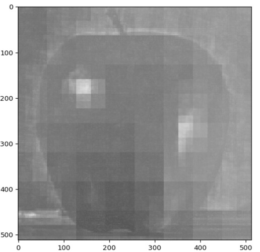

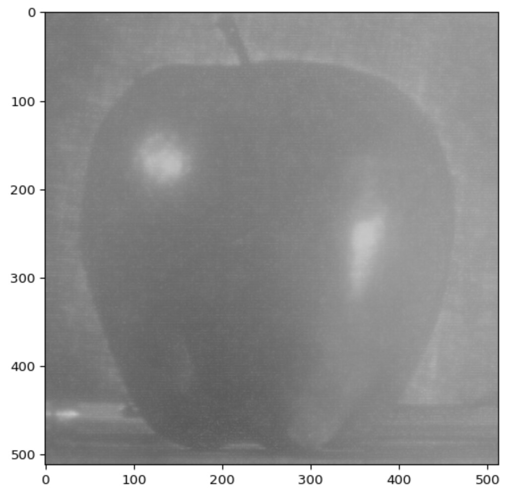

I tested the images in the laplacian pyramid with opencv-python,the problem may be in the pyramid up phase,the interplation type is incorrect.

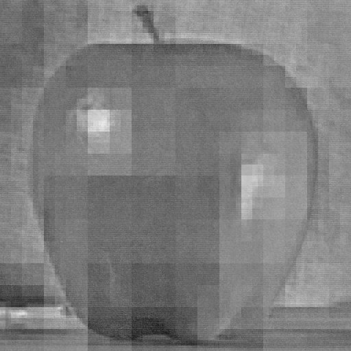

And I post here the raw image and reconstructed image from visionworks .
and the opencv implementation.

the opencv’s result is similar to the NV’s visionworks’
– visionworks’result
–opencv-interplation-iner-nereast
–opencv-pyrup

Based on the implementation, VisionWorks uses linear interpolation rather than the nearest neighbor.
Not sure why the result looks like an NN-based output.
Let us check this based on your source and get back to you later.
It seems that our VisionWorks doesn’t implement a lossless reconstruction so that the results will be different from the OpenCV.
