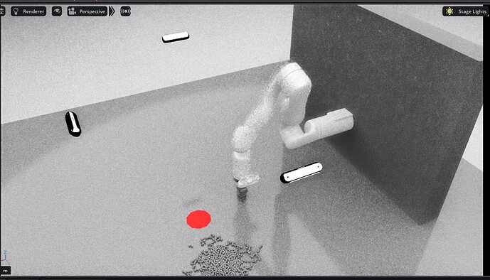

I have upgraded to Isaac Sim 4.5 with Isaac Lab 2.0 and now the rendeing of my simulation is all blurry. How can I make the rendering nicer?
When I set the rendering to pathtracing, the rendering comes normal again but gets very very slow (1FPS)

I have updated the 535 driver with the most recent version (535.230.02) and the rendering is still the same.
In Isaac Sim, the render is correct but it is only when I use Isaac Lab that I have this degraded rendering.

you need to set render cfg in isaaclab.
For example:
        # self.sim.render.enable_translucency = True
        # self.sim.render.enable_dlssg = True
        # self.sim.render.antialiasing_mode = "DLAA"
        # self.sim.render.dlss_mode = 0
