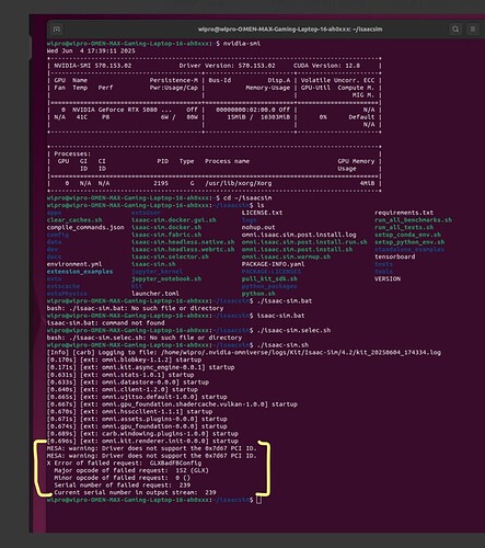

RTX-5080 - NVidia GPU driver issue on ubuntu 22.04

@ashish.waghmare2 there are know issues with Isaac Sim 4.5 and 50 series that the dev is currently working on (which may or may not be related directly to your issue):
but, i would also refer to the Linux troubleshooting page as it relates to the GLXBadFBConfig error:
/home/wipro/.nvidia-omniverse/logs/Kit/Isaac-Sim/4.2/kit_20250604_174334.log
It appears that you were launching Isaac Sim 4.2. Please also make sure to use 4.5.
May I ask if the problem has been solved
Did you mean Isaac Sim Rendering Issue on RTX 50 series? If so, it should have been fixed in Isaac Sim 5.0.
