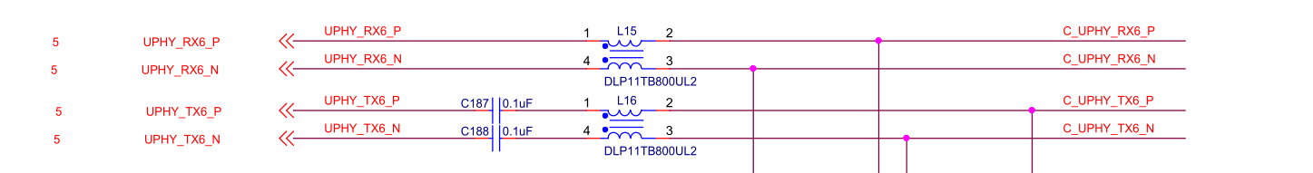

How many usb port are on your custom board? Board schematic to share?
"Previously this interface was available. " It refers to the period from the system startup to dispaly the login screen.the mouse is available. then the USB port is suddenly powered off.The same thing happens every time start.
There are four USB ports on our carrier board, and other ports can be used normally. The faulty USB port is directly connected to the SOC.

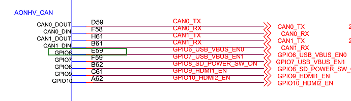

gpio@c2f0000 {
usbP9-0-reg-enable {
gpio-hog;
output-high;
gpios = <TEGRA194_AON_GPIO(AA, 5) 0>;
label = “usbP9-0”;
status = “okay”;
fixed-regulator dtsi
rtso1001_p9_0_5v0: regulator@115 {
compatible = “regulator-fixed”;
reg = <115>;
regulator-name = “usb-p9-0-5v0”;
regulator-min-microvolt = <5000000>;
regulator-max-microvolt = <5000000>;
gpio = <&tegra_aon_gpio TEGRA194_AON_GPIO(AA, 5) 0>;
enable-active-high;
vin-supply = <&battery_reg>;
A 4P hub is inserted into the carrier board,
Can we see what the problem is from the above?
I don’t think you need to write a usbP9-0-reg-enable here. Just give the rtso1001_p9_0_5v0 regulator to the vbus. Please refer to the adaptation guide for usb porting.

Also, do you really give the usb-p9-0-5v0 to the vbus-supply of your usb port? I see the log says it is getting disabled.
Which means no one is using this regulator.
[ 42.337881] usb-p9-0-5v0: disabling
