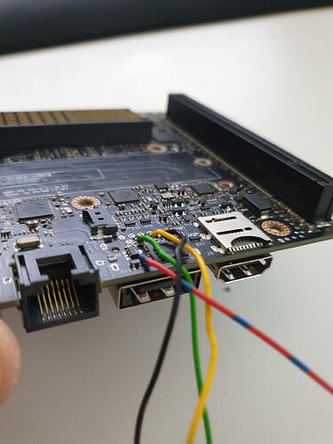

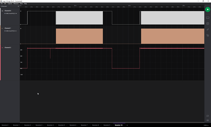

We analyzed D+, D- and GPIO22 lines using Salae logic pro analyzer on both our board and devkit. The example device is Mouse/keyboard dongle.
On the devkit you can see that during th UBoot phase, AGX talks to the keyboard, you can see the comonication stops at the time regular boot starts, and few seconds later, the comunication starts again.
Lines are in order D+, D-, GPIO22 (VBUS enable) after voltage level translator on the U2 pin of devkit:
On our board, you can see the same communication happening during UBoot phase - we see every message and we know device has enumerated and works as HID device during that phase. But after that, after the boot happens (when the high res NVidia logo appears), the communication never starts again. We have monitored debug terminal, and when kernel starts to load communication just stops.
Lines are in order D+, D-, GPIO22 (VBUS enable):
We are talking about same AGX Xavier, tested minutes apart, just plugged in another boards.
I really can’t figure out why the USB would work at the beginning, during the UBoot phase, and then just never start. I read trough the documentation, tried pulling GPIO22 to 1.8V, Tried pulling it down - nothing. As far as I see thre are no strapping pins that could affect this.

The graphs shown above are both measurements of the USB2 port 3 - on the DevKit I added tesponts on the D+ and D- of the eSATA connector.
As far as I understand, USB2 port 3 is Host only port on the devkit, which is a behavior I see when testing the devkit. But using that same port on my board - the communication stops working, using the same slave device as a test point, and using the very same Xavier plugged on different boards.
