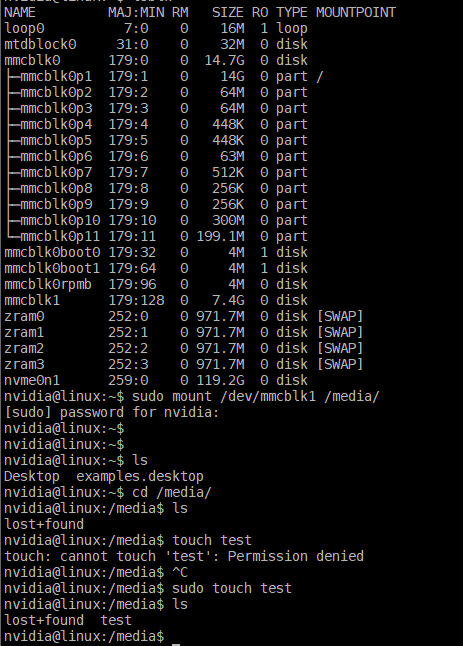

now, I’m working on Xaiver NX, i used sdmmc3 for sd card, and it’s working fine.
but, when it can’t be detect by hot plug in/out, i don’t honw what’s wrong with it.

yes, i’m sure. i can format it and mount it.also can read and write.

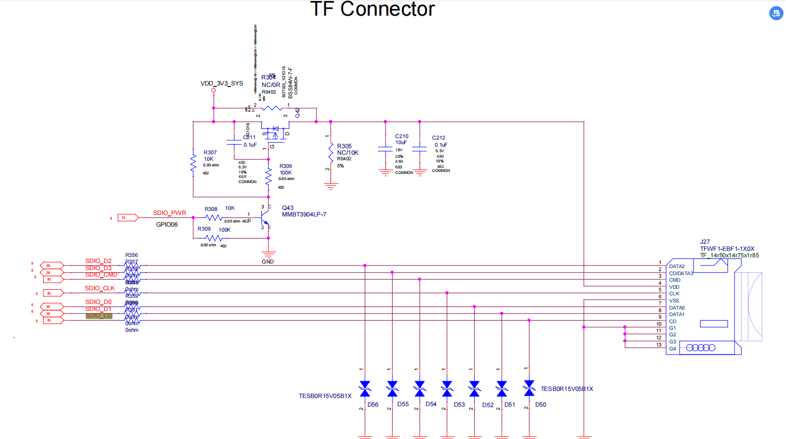

you should review the SD card connections.
please access Jetson Xavier NX Product Design Guide via download center and check the [SD Card and SDIO] chapter. please confirm your hardware connection is correct,
thanks

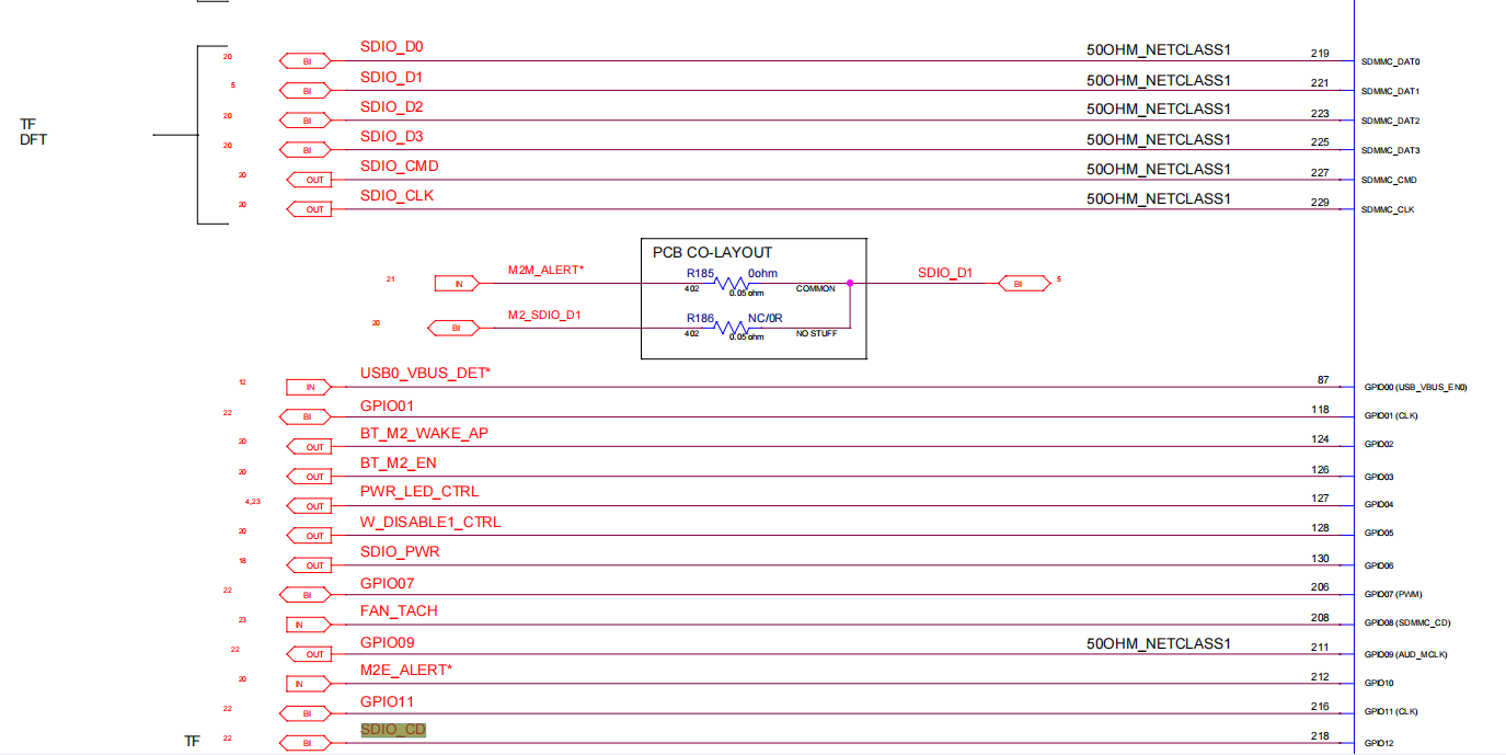

hello Jerry,
I checked,such as below picture, i don’t know the reason.
