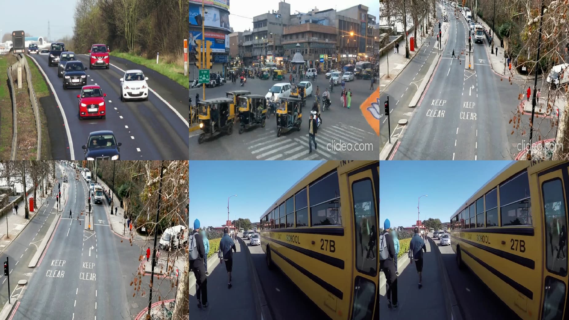

I’ve Followed this updated guide of YoloV4: YoloV4 Manual
Also the: Following Repo
The application is working, but ObjectList.size() reports 0 objects. Which means I’m not getting any bounding boxes as seen here:
After some debugging, turns out the confidence levels the network obtained is always less than 0.1
After Printing Object confidence output against the configured threshold, here’s the Deepstream Output:

Hi @yousef.hesham1 , Which application do you use with your model in deepstream? Could you provide us your stream? Thanks
Hello @yuweiw, Thanks for the quick response!
I’m using the apps/­deepstream-imagedata-multistream Sample application
If by stream you mean the video Im testing with, I’m using the following 2 files as part of 6 stream test:
file:///opt/nvidia/deepstream/deepstream-6.1/samples/streams/sample_1080p_h264.mp4
file:///opt/nvidia/deepstream/deepstream-6.1/samples/streams/sample_1080p_h265.mp4
And they produce no bounding boxes. Could it be an ONNX conversion issue?
====》Could it be an ONNX conversion issue?
It might be. You can try to test it with our yolov4 trt model and postprocess function. Thanks
Please refer the link below to download our yolov4 model.
https://github.com/NVIDIA-AI-IOT/deepstream_tao_apps
@yuweiw I tried the tao deployable yolov4 model (yolov4_resnet18_395.etlt) and here’s the output Im getting:
Can you assist with this please? Also I can upload the converted ONNX I’ve used when I first encountered this issue if it needs inspection.
From the video you attached, we can see that the lables show out. So maybe the way you draw the bbox is wrong. You can refer the draw_bounding_boxes fucntion in deepstream-imagedata-multistream file. Also you can draw anything in the picture as a test.
Hello @yuweiw
I understand that this function is only used to draw on image data extracted from the object meta, then is saved on desk.
And the actual drawing of the ObjectList bounding Box are drawn using NVIDIA plugins in the pipeline. Please correct me if I’m wrong.
And anyways I’ve double checked the function and it’s exactly the same as the original sample.
Could it be a conversion issue?
====>Please correct me if I’m wrong.
You are right. We use the osd plugin to draw.
https://docs.nvidia.com/metropolis/deepstream/dev-guide/text/DS_plugin_gst-nvdsosd.html
===>Could it be a conversion issue?
I think you used tao deployable yolov4 model, so there is no conversion.
Could you provide your change about deepstream-imagedata-multistream? Thanks
I did use the tao deployable yolov4 model and the results are shown above in the comments.
Not much changes were made other than adding tracker config.
The reason may be your post-process algorithm. I use the yolov4 model in our tao app to run the deepstream-imagedata-multistream demo. When use your post-process, it cannot draw the bbox, the object recognized is 0. But when I use the post-process in TAO app, it works well. You can try this from the link below:
https://github.com/NVIDIA-AI-IOT/deepstream_tao_apps/blob/master/post_processor/nvdsinfer_custombboxparser_tao.cpp
Turns out the conversion from original pytorch weights to ONNX was the issue, not the post-process algorithm. I had to use a specific pytorch version in order to generate a functioning ONNX file.
Many thanks
