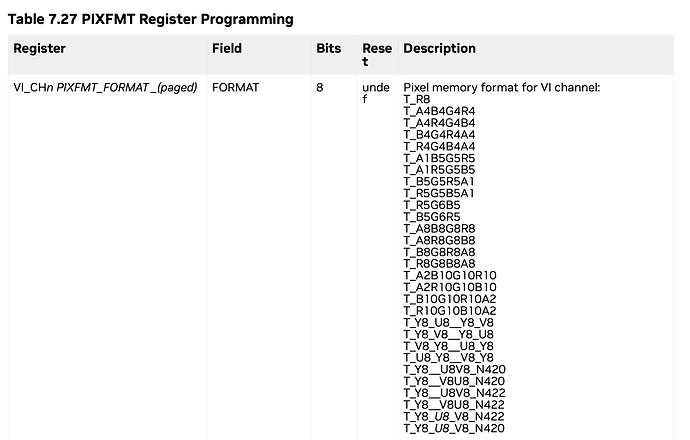

Here’s the VI reg setting. You can confirm this REG is set to correct.

1970-01-08T06:51:07.490622+08:00 tegra-ubuntu-pos kernel: [RCE] VM0 deactivating.VM0 activating.VI ch[35] frame configuration: 2592x1948
1970-01-08T06:51:07.490633+08:00 tegra-ubuntu-pos kernel: [RCE]     left skip pixels=0 top skip lines=0
1970-01-08T06:51:07.490635+08:00 tegra-ubuntu-pos kernel: [RCE]     right crop pixels=2592 bottom crop lines=1948
1970-01-08T06:51:07.490636+08:00 tegra-ubuntu-pos kernel: [RCE]     pixel format=VI_PIXFMT_FORMAT_T_Y8_U8__Y8_V8 fmt=16

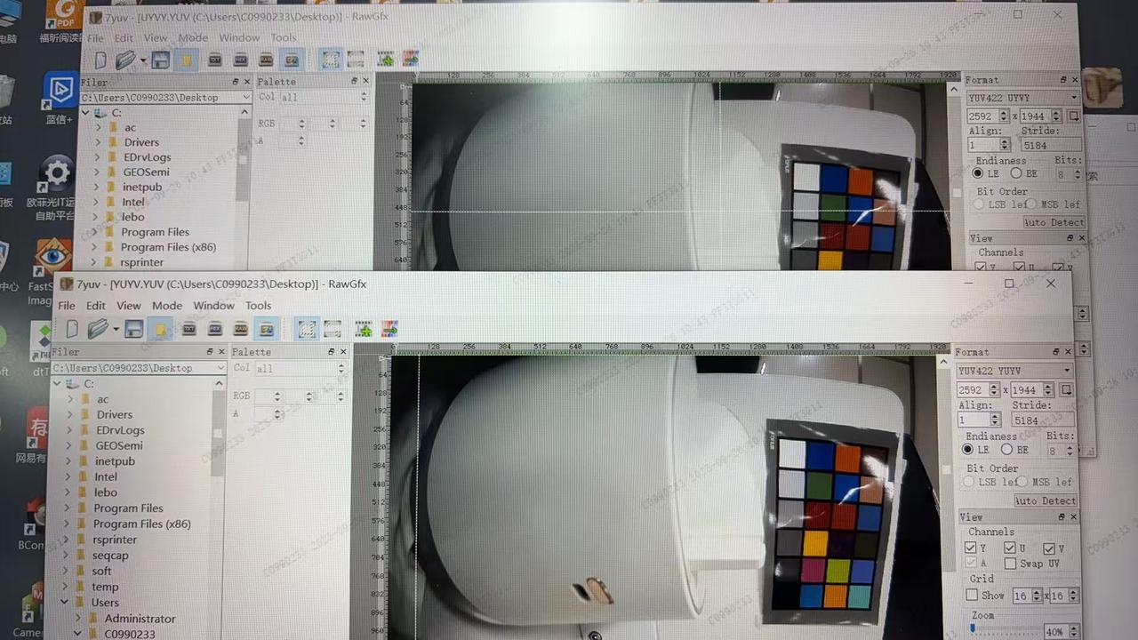

but the dump yuv image use YUYV to preview is wrong color, and use UYVY to preview is correct.

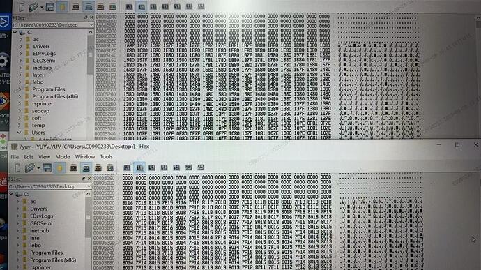

Could you provide the frame dump attached here.
FYI, resolution is 2592x1944 + head 4 line embedded data.
yuv_image.zip (10.9 MB)

The sensor output YUYV and UYVY is correct, you can refer the attached that we checked.
That’s confuse! Then what’s wrong?
Config device tree pixel_phase = “yuyv”, VI receive is wrong.
If you configure device tree to YUYV, our VI should expect frame data in YUYV. It should be the camera sensor not outputting in YUYV. Would suggest check this further.
This is the oflim camera factory test result, the camera sensor is outputting in YUYV.
Attached yuv_image.zip incudes UYVY_format.yuv and YUYV_format.yuv. Both can be viewed correctly on YUV viewer by setting view format to UYVY. Please check why you configure the camera sensor to output YUYV and it outputs UYVY instead.
