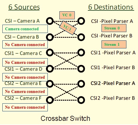

Hi All,
Is the below scenario feasible with TX1/TX2?
  1. I have two camera streams coming from a single source
  2. This single source is connected to CSI-A (or any other CSi ports)
  3. Each stream is distinguished using Virtual channel (VC) ID in packet header. Say 0 & 1
  4. Camera stream with VC0 is directed to Pixel Parser A(PPA) & camera stream with VC1 is directed to Pixel Parser B (PPB).
If this is possible,
  1. Can all this configuration be done via dtb (E.g: mapping VC with PPA & PPB)?
  2. Is the usage concept like /dev/video0 is mapped to PPA and /dev/video1 mapped to PPB?

Hi Chijen,
My CSI camera is connected to only one CSI port (E.g. CSI-A,2 lane). However I need to send 2 different streams through them and wish to distinguish them using Virtual channel concept.
i.e., one stream is directed to CSI-A and the other to CSI-B. Hope you get a better picture now.

Hi Chijen,
OK so this is an one camera using CSI 2-lane connection and you intend to get each stream from each lane, correct?
Partially correct :) Yes, its 1 camera using 2-lane. BUT each stream use 2 lane. 1 stream is directed to PPA and the other to PPB using Virtual Channel ID.
Hope the attached image makes it clear.
Regards,
Rejeesh
Rejeesh,
Ya it’s more clear now. Although we have not had the chance to validate virtual channel for our V4L2 camera driver due to lack of hardware device, mapping to a different device node for each virtual channel is the right thing to do. Hope you could make it work. Please let us know should you encounter any issue.

Hi Rejeesh,
do you have solved the problem? I also meet the problem.
my platform is :
2 X sensors + 2 X DS90UB913 + DS90UB964 + tx1
the DS90UB964 combine the two streams from two sensors to a source output to CSI-A on TX1.
one sensor stream using VC0, another using VC1.
but the TX1 receives only one channel stream from either VC0 or VC1 at present.
because I just used the PPA to handle these stream and don’t konw how to use the PPB to handle the stream from CSI-A port.
also I config the reg CSI_PIXEL_STREAM_B_CONTROL0_0 bit0~2 to value 0x0,which indicate the PPB source is CSI_A,
but it seem doesn’t work.
Could you check if DS90UB964 can support 4 lanes and 2 lanes output VC0 another 2 lanes output VC1, otherwise we can’t support it now.
