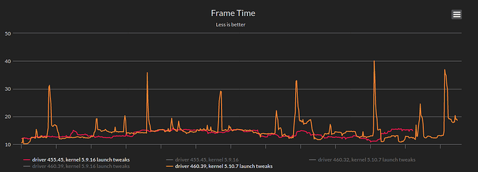

Since I upgraded my Nvidia driver to version 460, I noticed significant performance regression in Red Dead Redemption 2. I am experiencing constant short framerate drops that happens every couple of seconds. This behavior is consistent and is not affected by the in-game surroundings. Once or twice the framerate dropped to stable level around 40 fps and stayed this way for another 5-10 seconds. Other than that the game runs perfectly smooth.
This sort of behavior wasn’t present with the 455 driver I used before. In fact, back when it was the stable version, I decided to try the (then beta) 460 driver and this stuttering was already present. I was just hoping that it would be resolved before 460 was considered stable.
I am running the game using Steam Play (Proton Experimental) with Vulkan as the rendering API in 2560x1440. I recorded the described behavior with MangoHUD. The log can be viewed here: FlightlessMango

Benchmark results with the 455 driver (2020-12-30):Benchmark-20-12-30-02-44-55.txt (2.0 KB)
Benchmark results with the current driver (2021-01-26): Benchmark-21-01-26-15-35-47.txt (2.0 KB)
EDIT: I also noticed that GPU usage drops from 95+% down to 60-80% during these slowdowns.
EDIT 2: I uploaded more data series (different drivers, kernels and launch options). The performance difference between 460.xx and 455.45 is very clearly visible now: FlightlessMango (sorry for not keeping the logs equal length)

I don’t think that addelucas1977’s problem is related to the exact issue I was describing, but I finally managed to fix my problem.
I took a quite long break with RDR2 - I just recently returned to it. Unfortunately, I noticed that the driver version 495.44 also exhibits the performance drops, though it seemed that weren’t so common and significant. A couple of days ago I learned about Feral Gamemode and decided to try it out on RDR2. To my surprise, the performance issues have disappeared completely since I added gamemoderun to my Steam launch command. I wish I had came up with that earlier.
Proton version: 6.21-GE-2
Steam launch command: __GL_SHADER_DISK_CACHE_SKIP_CLEANUP=1 __GL_SHADER_DISK_CACHE_SIZE=100000000000 __GL_YIELD="NOTHING" __GL_ALLOW_UNOFFICIAL_PROTOCOL=1 PROTON_HIDE_NVIDIA_GPU=0 PROTON_ENABLE_NVAPI=1 WINEDLLOVERRIDES=dxgi=n,b PULSE_LATENCY_MSEC=60 gamemoderun mangohud %command% -adapter 1 -vulkan -USEALLAVAILABLECORES -cpuLoadRebalancing -ignorepipelinecache
Please note that my launch command involves all sorts of attempts to eliminate the infamous ERR_GFX_STATE crash. Frankly, at this point this is just some sort of shotgun debugging… Anyway, with these settings the game still crashes sometimes, but not as often as it used to without them (or so it would seem). I’m quite confident that gamemoderun was the solution to the performance issues, though.
