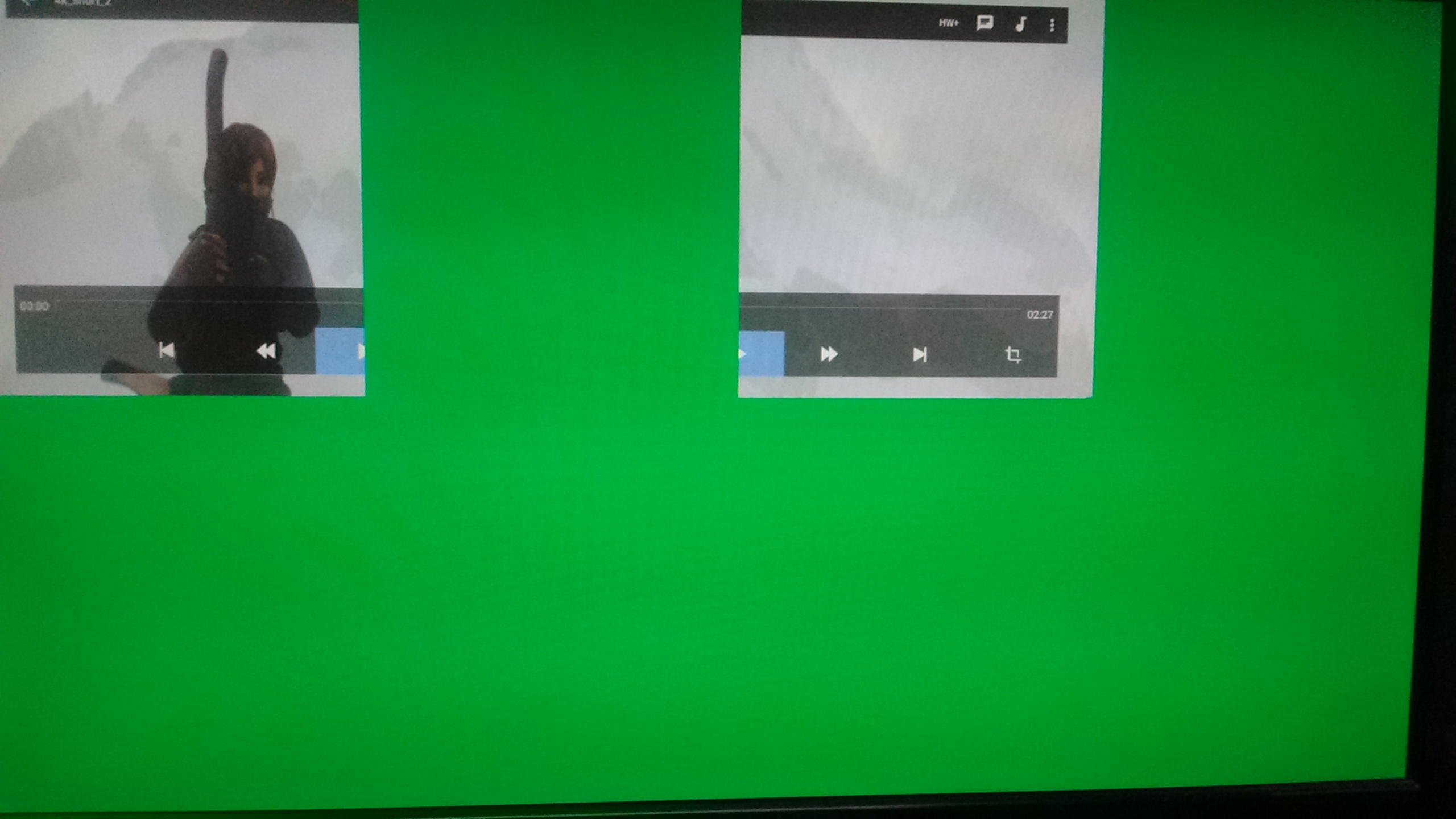

Hi kamm,
I was able to flash the latest APP and EBT image. I tried to get the 4K30 capture running with the gstreamer pipeline.
gst-launch-1.0 v4l2src device=/dev/video0 do-timestamp=true ! ‘video/x-raw, width=3840, height=2160, framerate=30/1, format=UYVY’ ! nvvidconv ! ‘video/x-raw(memory:NVMM), width=3840, height=2160, framerate=30/1, format=I420’ ! nvoverlaysink sync=false
But my output is as shown in this pic. I am using nvidia shield as the source.

Hi
The HDMI2CSI driver does not restrict the allowed formats to what you specify in the GStreamer pipeline. So you have to “know” in advance, what format your HDMI source delivers.
The Nvidia Shield appears to be set to a fixed output of 1080p. If you connect the Shield directly to a HDMI TV/display, you can set the resolution in the menu:
Settings → HDMI → Resolution → 4K (30Hz)
After that you should be able to capture 4K from the Shield with the GStreamer pipeline you used.

I changed the settings in Nvidia Shield to use best resolution, with that the above issue is solved.
