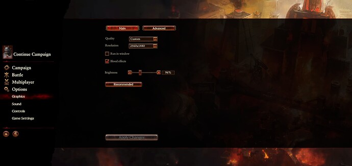

Summary from first test: issue happening only on specific benchmark and it needs to be launched first.
After that, I tested on other graphical settings.
env var: mangohud %command% (xwayland).
  1. Options → Main → Quality → set to Low → “battle benchmark” → finished successfully.
    After successful benchmark → Options → Main → Quality → set “Ultra” → “battle benchmark” finished successfully again on same session.
  2. Restarted the game, then: Options → Main → Quality → “Ultra Preset” ( was saved from previous launch ) → battle benchmark → game freezes. Closing the game.
  3. Restarted the game. Options → Main → Quality → set to High → "battle benchmark → finished successfully, then → Options → Main → Quality → set “Ultra” → "same benchmark → finished again.
  4. Restarted the game. Options → Main → Quality → verified that it’s “Ultra” → "same benchmark → freeze.
So, graphics settings, type of benchmark and order of “loading” do impact on reproducibility.. somehow.

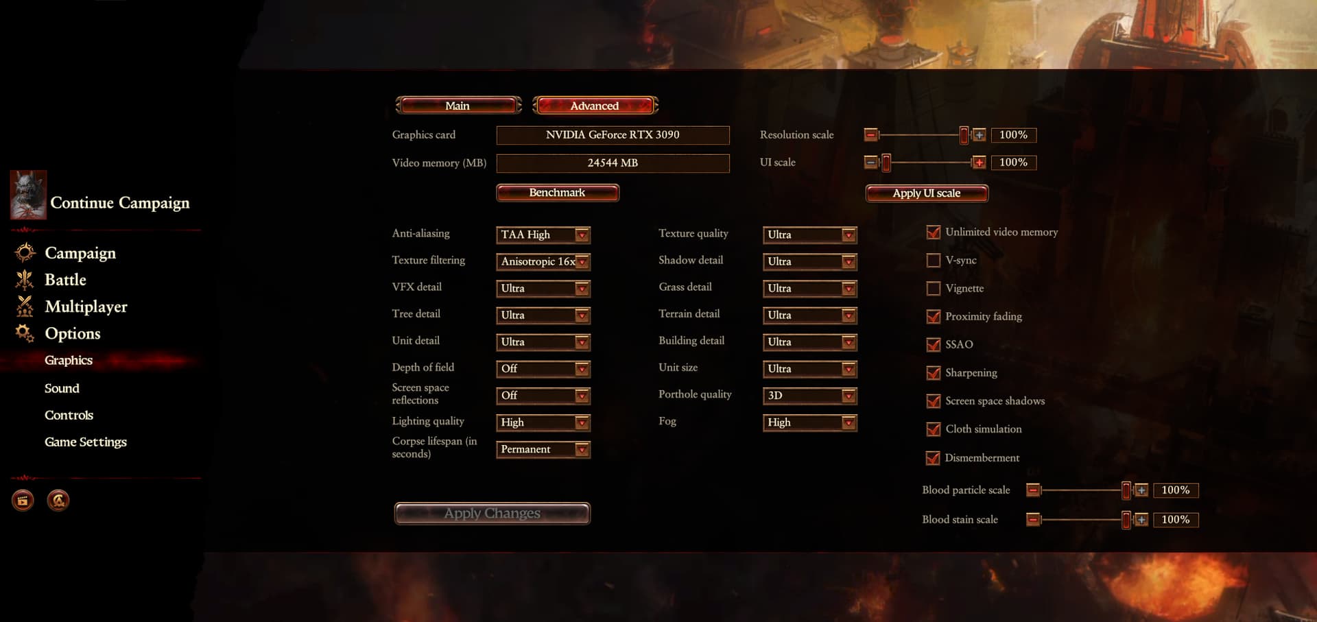

Update: NTSYNC also required to reproduce this issue.
No game mods.
No scx/other schedulers were used during this test. Only Linux baseline one.
Kernel 6.16.0. Driver Version: 580.65.06
Graphics Settings that reproduce issue for me
