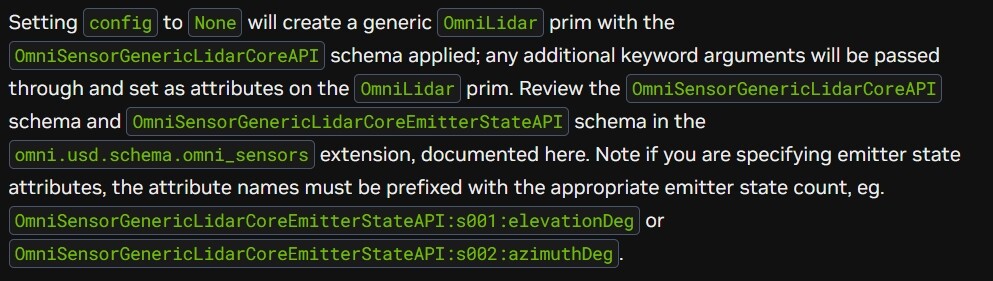

It still failed. The official documentation only uses “Example_Rotary” as a case study but doesn’t explain how this example was created—it only describes how to load it, which I find inappropriate. In versions before Isaac Sim 5.0, we loaded a “json” file, and I could simply configure that json. Even if I wanted to load “sensor_attributes,” I hoped there would be a template or documentation for it, but currently, there is no documentation or example available.
First, I couldn’t create it successfully because the documentation is too sparse, and I don’t know where I went wrong with the configuration. In the package files, I found the json file for “Example_Rotary,” but I couldn’t locate the “.usda” file, making it difficult to use as a reference.
I also have another issue that the documentation doesn’t address: If I create an “Example_Rotary,” do parameter adjustments through the “GUI” panel take effect? It doesn’t seem to work.
Hi @Julie_A!
According to your error message, it looks like you are using incorrect attribute name. Please find correct attribute names here: Omni Sensors Schema — Omniverse Kit.
Please correct your attributes and try again.
For the .usda file, you can get them from the asset packs.
It should, yes. Several attributes will not take effect if updated during runtime, but those are marked in the tooltip (if the you hover with your mouse over the attribute name) and in the schema docs linked above.
As for the missing link for OmniSensor schemes in the doc, our engineers will fix it. Thanks!

Thanks for your feedback about the documentation. I have provided this feedback internally and hopefully we can make our documentation more user-friendly.
For the script, how are you running it? Are you running it as a standalone example or via GUI script editor?
