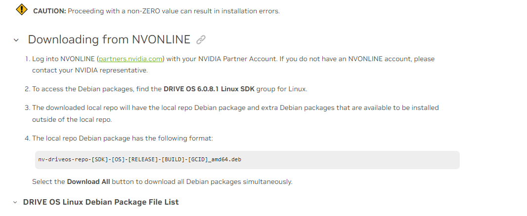

After installing DRIVE OS 6.0.10 in the way of docker container and building the example applications for DRIVE OS, we found that orin could only achieve the establishment of tensorrt engine and could not achieve the inference process.
I followed the steps exactly, and while I could successfully create the TensorRT engine, it was unable to perform inference.
We would like to try using NVONLINE to download the .deb package for installing and configuring TensorRT. However, when we attempt to download, it requires special permissions. We are a university institution and would like to know how we can apply for NVONLINE access.
The AGX Drive Orin has been purchased for quite some time, but we have had ongoing difficulties configuring the environment. We would like to start using it as soon as possible.
Dear @zhangpeixing,
NVONLINE access requires seperate engagement.
Could you please follow the guidelines at Announcement from NVIDIA: Guidelines to create a new topic when filing a topic.
As I understand, you face issues when running TRT sample on target. If so, could you please update the topic with error noticed and full logs for guidance.

Dear @deng.shigang ,
Could you please update which sample has issues?
If the error is related to any missing input files, please copy the input files to target from docker.
