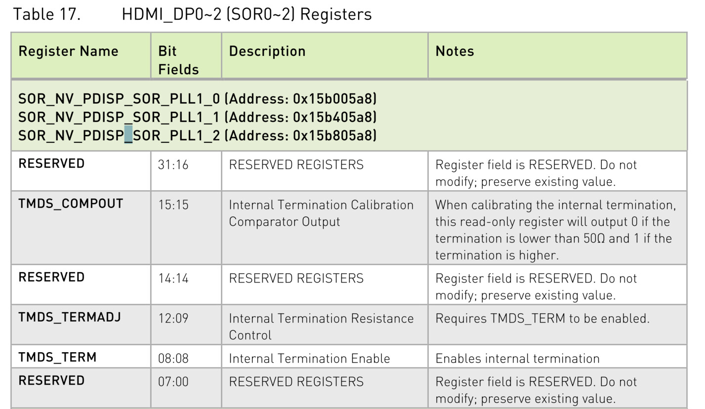

Agx xavier industrial hdmi compliance test reading SOR_NV_PDISP_SOR_PLL1_0 0x15b005a8
We are planing to do hdmi compliance test on agx xavier industrial and our custom board with R35.6.1.
The sysem crashes after running sudo busybox devmem 0x15b005a8
Please see the error messgaes below.

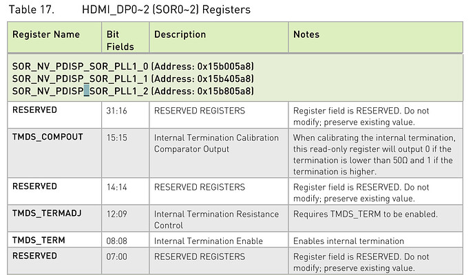

The register address 0x15b005a8is from Jetson_AGX_Xavier_Series_Tuning_and_Compliance_Guide_DA-09855-001_v1.3.pdf
Why does the system crash?

Hi yenchao,
[ 22.266677] tegradc 15200000.display: blank - powerdown
[ 22.266723] tegradc 15210000.display: blank - powerdown
[ 22.266746] tegradc 15220000.display: blank - powerdown
Please test again with all these have monitors connected first.
